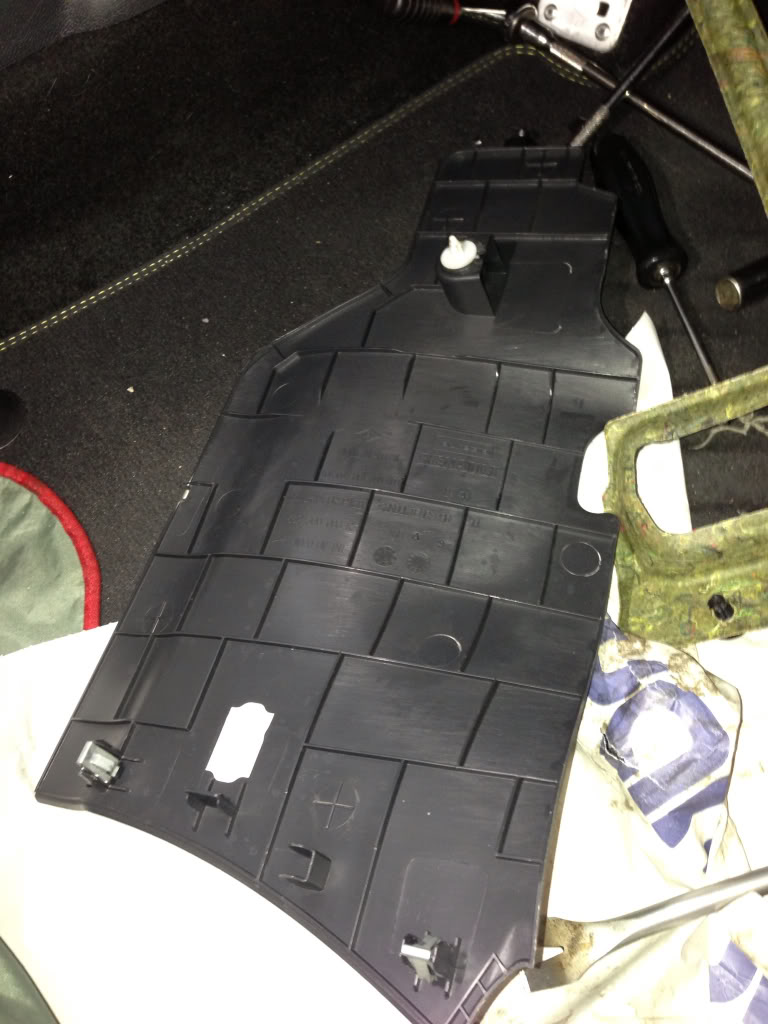

Anyway, to start, remove the under dash felt panel, it is held with 3 pop clips.Then take off the kick panel next to the clutch. This just pulls off, here is a pic of the fasteners on the rear

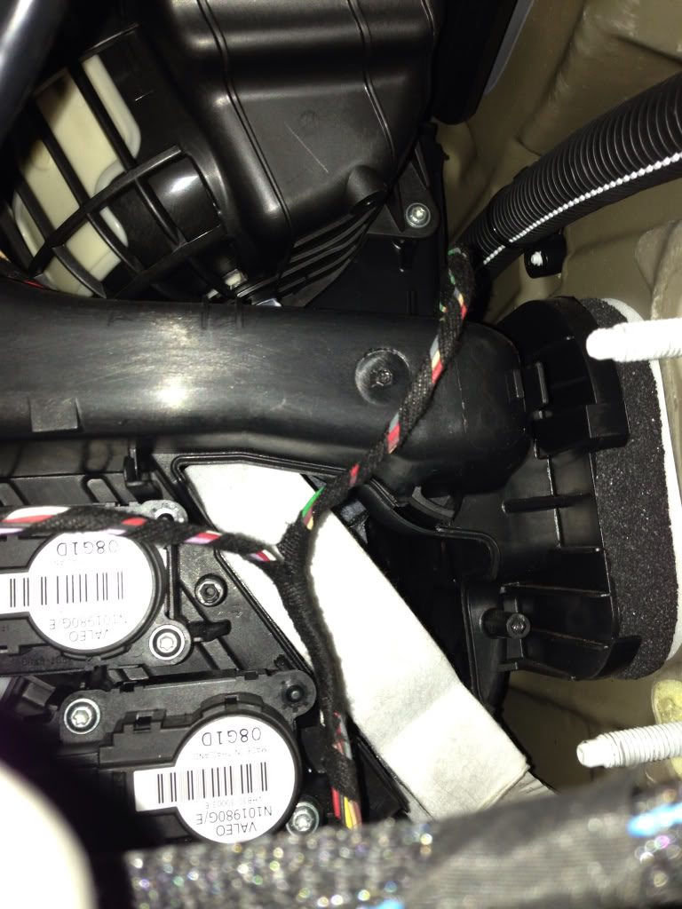

Now you will need to locate the removable panel, which is difficult to see, and where the pics will help.
The screws are 20 Torx head, and silver, there are just two.

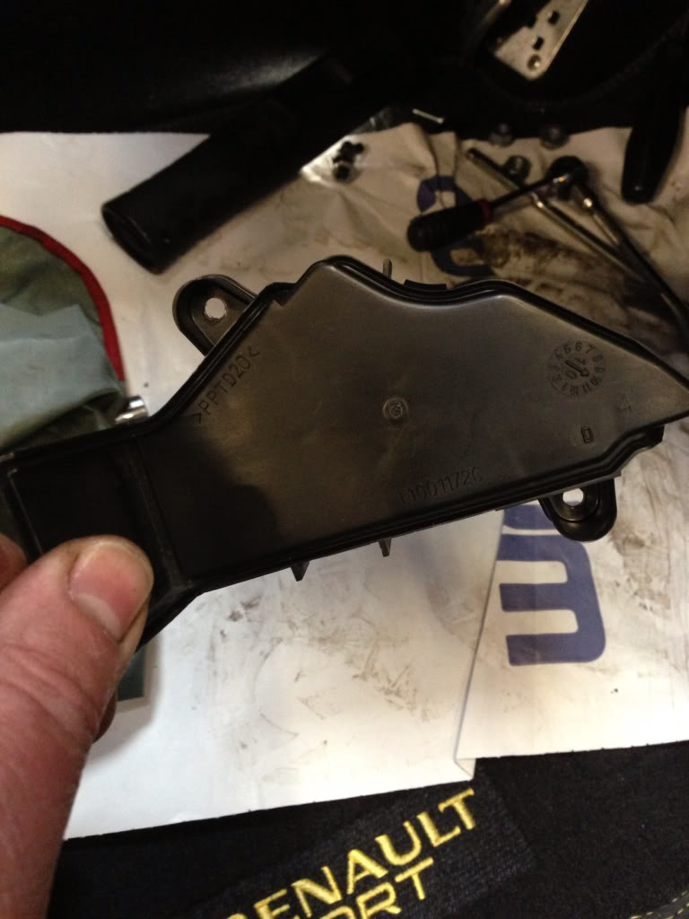

This is the panel off
