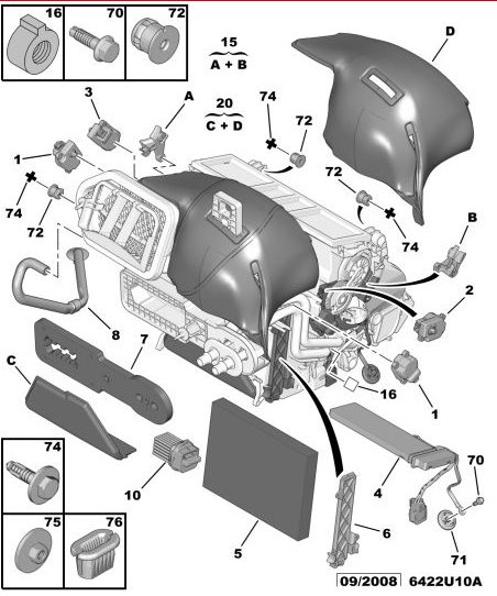

Sorry about that I can't get the photos to paste here. http://service.citroen.com/" onclick="window.open(this.href);return false; This is the site I downloaded the pictures from but it is a pay for service and I bought 1 hr access. I was desperate to find the pollen filter and this was the only way I could get the info. If it is possible to privately send me an email I will see if they can be sent as an attachement.

Here's a pic from service pages. I hope this helps. I don't remember if this was from LHD or RHD.
#5 - pollen filter, #6 - filter plug
