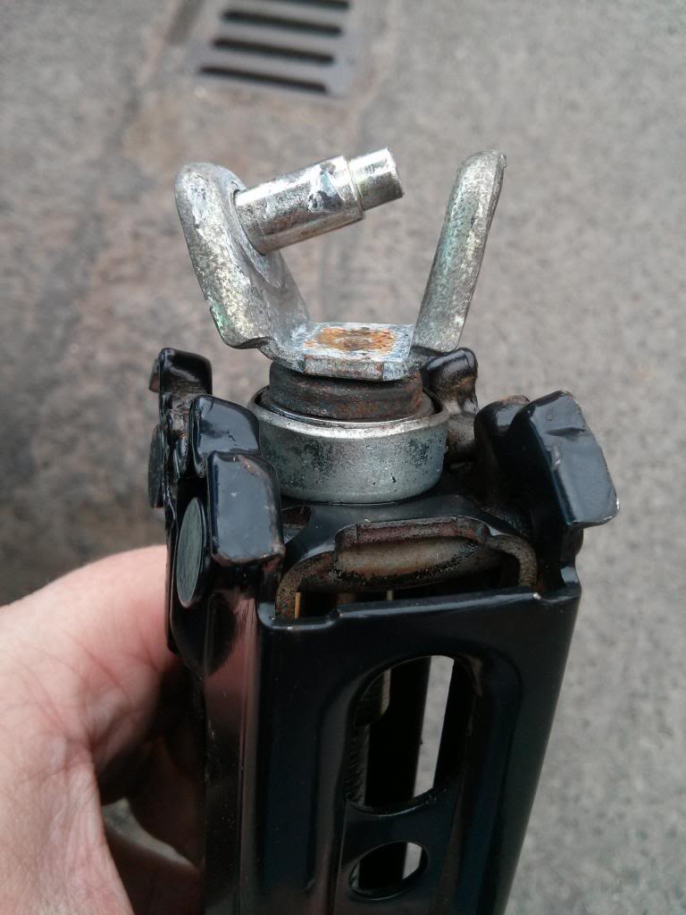

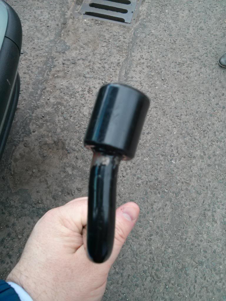

This was the second handle this has happened to. Really poor quality soft metal. Either than or I am Doctor David Banner.
http://www.snapfish.co.uk/snapfishuk/sl ... napfishuk/" onclick="window.open(this.href);return false;
So got bolt off eventually and then this happened. Woohoo. I AM Doctor Banner!!
And we couldn't get the bloody wheel off. It had seized on. Weird after only five months of the wheel having been put on. Took an hour of hammer and wood. All done in a field. Need new jack etc.

Just seen the pictures. Hello Dr Banner! Please don't get mad at me!

I've done this to the "wheelbrace" on a couple of Xantias and a 306. I think they are made of a particularly soft French cheese.boristhespie wrote:Had fun Sunday. Pothole killed tyre. Bloody roads are a disgrace.
Anyhoo!
I managed to snap the end off a 3/8" extension bar last week. I'm sure the quality of tools is getting worse. I'm certainly not getting stronger.

Re: reliability in an emergency
This is the second handle this has happened to. You are right, cheese indeed. It's like a soft alloy.
I think the only thong regarding jack is size. Would love a trolley jack but carrying on of them about would take up too much room would it not?

French cheese even!boristhespie wrote:You are right, cheese indeed. It's like a soft alloy.
No, it's not that, it's the fault of the gorillas they use in tyre places to do wheel nuts up who leave their rattle guns on 'near-shear'
If the tyre people took more care over their job then the supplied bar would be quite adequate for the job...
