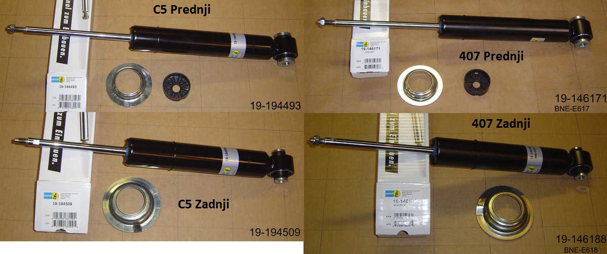

Anyways I've found some photos of Bilstein B4's (OEM Replacement) shocks and they look pretty much the same, although the photo cannot be 100% relevant but still they are very very similar.
I've also sent an email to Bilstein.
Here is the comparison photo
Prednji means Front, Zadnji means Rear (as marked on photos)
Thanks all
54026356

here is price and part No. from citroen
Part Number Description Quantity Price excl. VAT Price incl. VAT Total incl. VAT Selection
0000520895 FRONT SUSPENSION SHOCK-ABSORB 54.33 GBP 65.20 GBP 65.20 GBP
00005206PL REAR SUSPENSION SHOCK-ABSORBER 54.33 GBP 65.20 GBP 65.20 GBP
i tried checking on puh service box but its playing up at the moment, i will have another go tomorow
