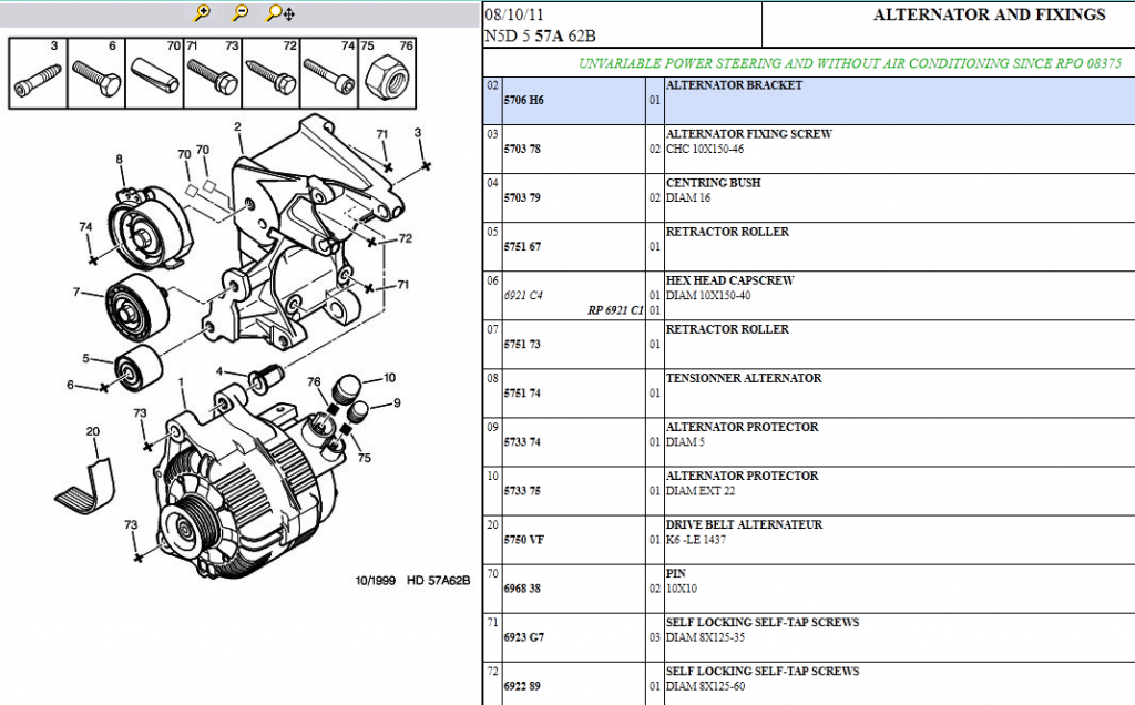

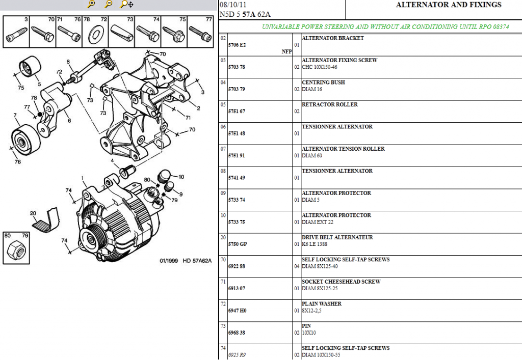

Before build 08374 its about the same as the XUD one with A/C ie that annoying tensioner. Later ones are slightly different:
Two pics, early and late. I could not find a pic of it all "assembled" but these should hopefully help a little bit.
How to tell ? , see item (8) on the early pic, you should see that at the top pointing nearly upright its a threaded bolt.
Pics from models with PAS but without AC (all UK spec models had PAS at this year though)
EARLY
LATER
EARLY
LATER

thanks for the diagram, mine is a phase 2 without a/c as in the first diagram.

the usual thing that fails is the pivot bearing in No. 6 of the top drawing,
this is the auto tensioner,
either way it wants sorting ASAP as if any of it fails it can take out the cam belt
