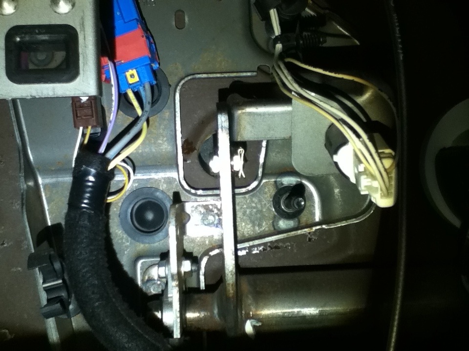

Ok took out glove box. Hate taking car apart. Feel I am not up to it. Darn hidden screw underneath had me for a while. Then the light connector. Anyway left it all out until I asked you guys. From this piccie do I have the switches? I only see one plunger type. Is that the right bit I am looking at. Do i have the requisite switches? I assume 4 wires means yes and its just a case of pluggin in stalk and lexia it?

should have just lowered the carpet below the glovebox if you have a 4 wire switch you should be ready to go once you have switched on rvv in injection menu

I pulled down carpet but never saw switch. I may have seen wires but to tell you the troof, I really don't have a Scoobies what I am doing most of the time.
