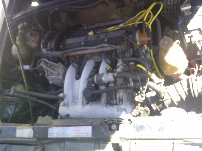

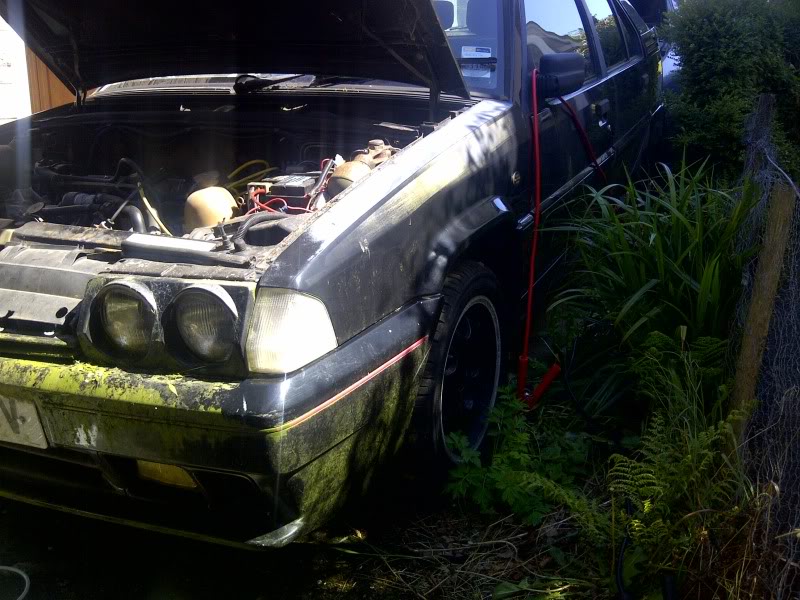

have been up at the car today, attempting to get it started, i've discovered that the battery is Definitely dead and almost cooked the Xantia alternator in the process of getting it going!! Chucked in another gallon of fuel, towed it up the drive with the Xant so could get the Jump leads on,popped the cap off and gave it a clean up on the inside but theres quite a bit of build up on the contacts, scraped it off and cleaned the arm up, pulled the old plugs out as they were black, popped in an old set, and gave it a go,
sadly the intention of it firing it up instantly Didnt happen lol! had it for the best part of an hour off the Xant (discovered that the T bar shape plug spanner with the spring slid up and the end bent sits between a couple of hoses and the throttle lever on the TD perfectly to keep it at 2k!!), it was Almost catching but not quite, left it a bit, sorted the drivers door lock out as that had stopped working due to popped off rod, tried the car again, but nothing, and again, then realised i'd turned the ignition off (starter button on the dash due to old wires!!), D'oh! So!! turned the ignition on and tried again, Almost,
this went on for some time, the good lady came out to help and with her in the bx and me on the Xantia throttle it fired up revved and died, getting there! tried some more, this created the Poof of smoke from the Xant Alternator Ooooooooooops!! but it fired up and ran for a few seconds, missing like mad mind (have just thought now am home that one of the ht leads was a bit loose!!) but it ran! Mrs used to driving the td estate hit 6k rpm mind! :shock: but it did run so progress has been made,

dug out a spare cap from the shed over the week and popped it in the pot to take up, turns out, wasnt as good as it looked, but after a quick clean of the plugs, a good spell on the jumps from the Xantia after half a dozen Good goes it fired up! Idled a little high at just under 1400rpm but it was running nicely, cleared through the gunk it had sucked up from the tank,
Shot up on the suspension too which was pleasing, despite it Throwing fluid out the octopus, Pleasing day!!! one step closer to coming home!!!
was smokin like a good un as youd expect but didnt show up so much, - Still sounded Ansome though!!!!
