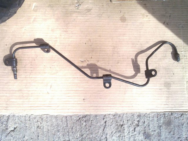

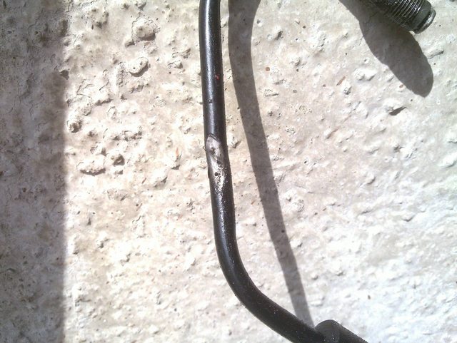

So I finally got the pipe off.
The worn bit was against the bottom of the alternator. I could probably braze it but I don't have any donor pipe.

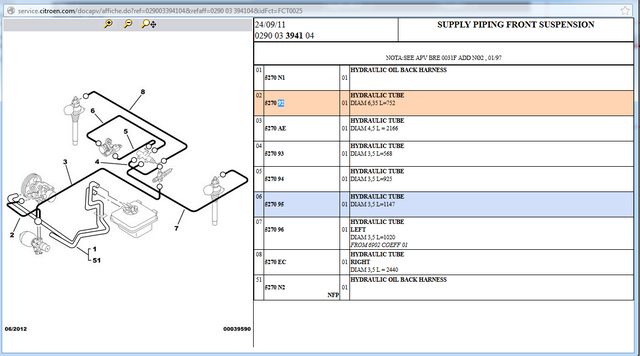

So I eventually found my way to the Citroen service site and made an account. This allowed me to view the microfiche. I then entered my VIN which seemed to narrow down the choice to one car. Now I just need to be absolutely certain, is number 2 (5270 92) on this diagram the correct part number for this thing.

if you entered your chassis/VIN No. into service citroen this will be your car specific, so yes that should be the correct pipe,
i just checked that part No. and it still shows as available from citroen dealer
and below is price and part No.
Part Number Description Quantity Price excl. VAT Price incl. VAT Total incl. VAT Selection
0000527092 HYDRAULIC TUBE 17.69 GBP 21.23 GBP 21.23 GBP
