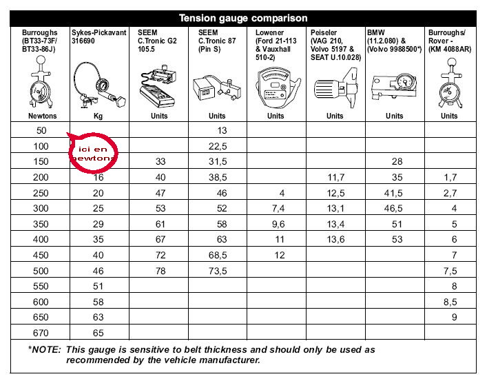

I was given one of these
with some conversion chart as it would appear that all SEEMs are not equal, except there was no mention of Citroen SEEMs.
I used it to take a reading on the old belt, fitted the new belt using the twist method and then took a reading on the new belt. The two readings were just about the same so left it as it was, 13 months and 30,000 miles later all is well so I guess it must have been OK.

Different manufacturers have different measurement 'scales' that's all and there's at least two type's of 'Seem' as well.
Pic that I was supplied with a while back from Jim...
My tension gauge looks like the one on the left (or far right) I think its in lbs though not sure.

Yep that's the chart I got as well - didn't make me any the wiser though!!!

So despite all this fancy technology and conversion tables we're just back to the tried and true "twist longest run 45 - 90 degrees" ?
Amazing how manufacturers make such a complicated business out of something as simple as adjusting the tension on a belt! Where is the need for proprietary made up units of measurement when we already have Newtons...
