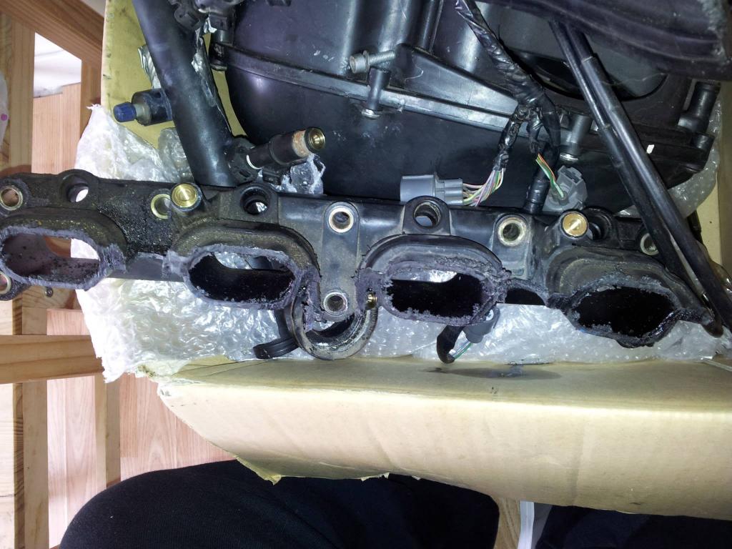

These are going on shortly, CANNOT WAIT! Chose 38mm Honda CBR600's for the early peak torque. Should get close to the gains this 206 got with 40mm's http://www.evo.co.uk/carreviews/evocarr ... 6_gti.html" onclick="window.open(this.href);return false;
'Custom' inlet manifold - really just a chopped up stock manifold. Only needs hoses to connect!

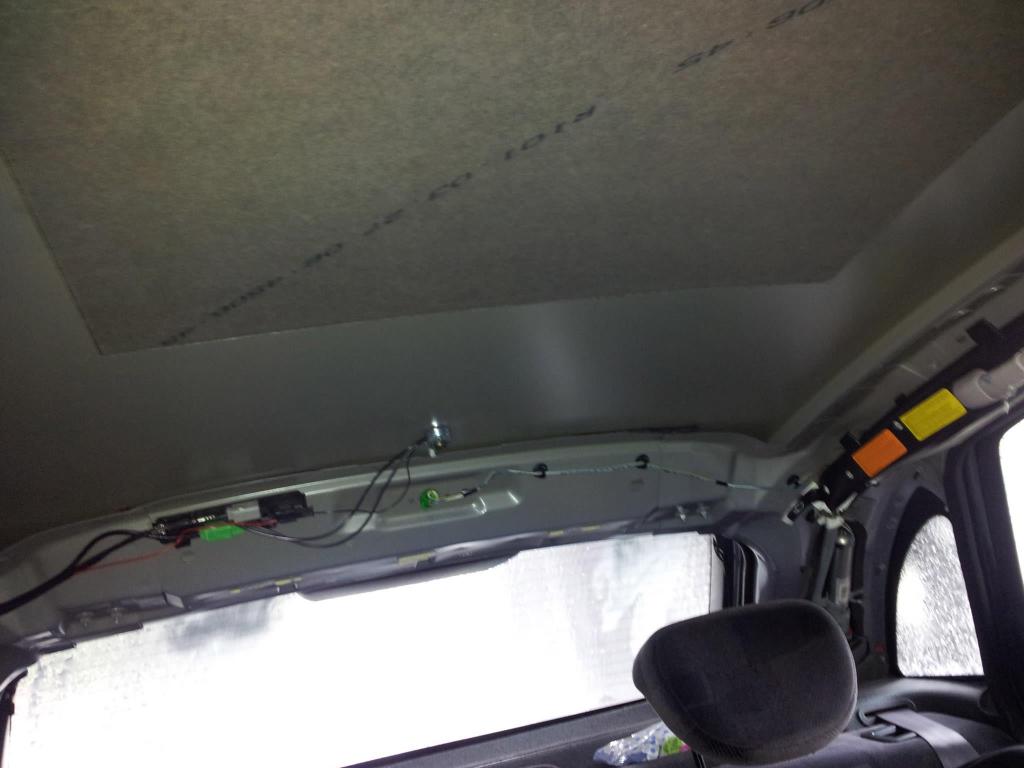

Goodbye roof lining

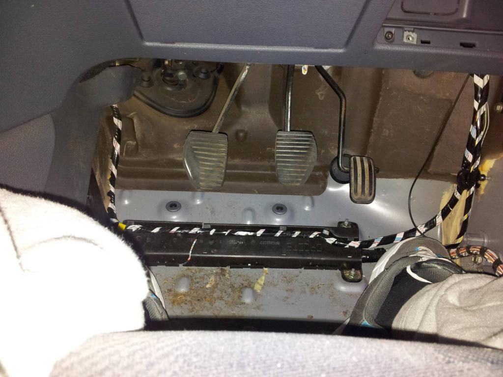

No carpets

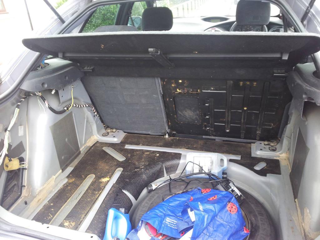

Boot with emergency tool bag. Spare is only in as I'm off to get a tyre

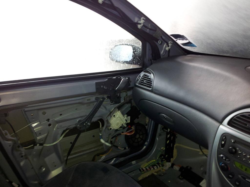

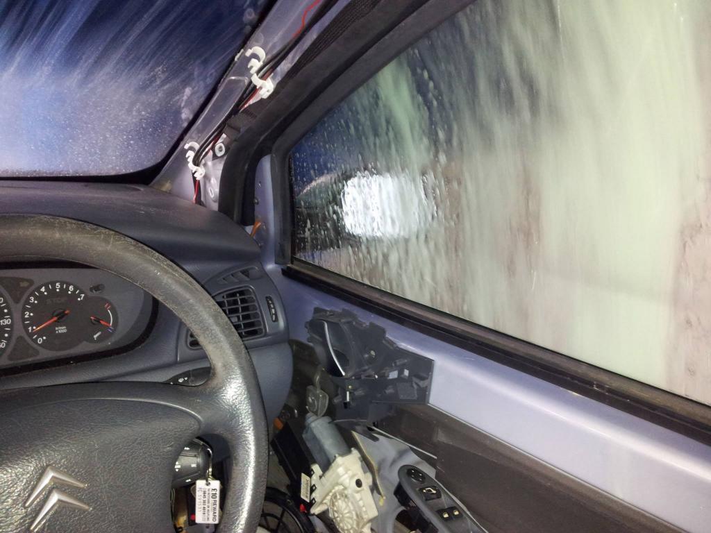

No door cards - taken at the car wash
Goodbye roof lining
