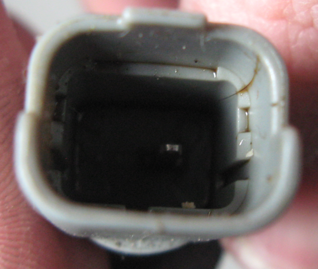

Yeah the single wire thing gave me the heebie jeebies when I replaced mine... thought I may have broke it or something
Looks like it's in the exact same place as mine too - as you can see is a piece of cake to replace!

By pure coincidence whilst I was clearing out the car today I found the one I removed, just to show you're not going mad, you can see the sensor itself only has a single pin
