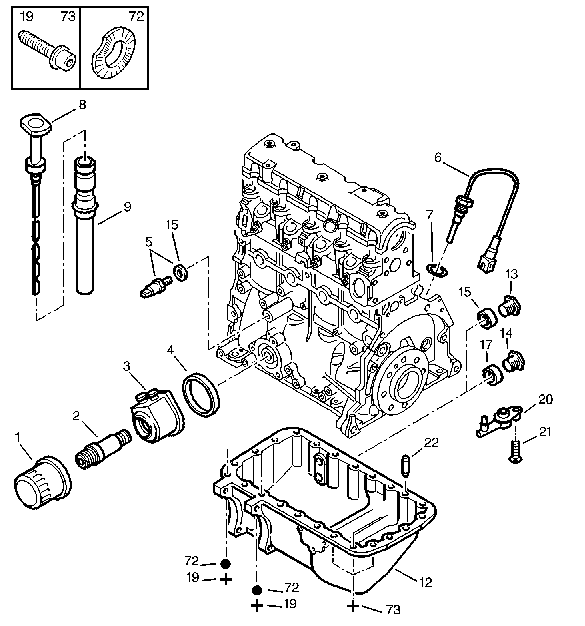

Hello is the oil cooler on the oil filter housing or somewere else?
thanks
spider
Posts: 3949
Joined: 05 Jan 2010, 14:28
x 77
Re: Headgasket or oil cooler problem 306 hdi
Unread post by spider »
On the oil filter housing, the same as the XUD's really.
You'll see it, its bolted (well a 'fork' and the central nut) to the oil filter aperture on the block itself.
You'd want a new seal if you remove it (between block and cooler) I seem to think these are actually just an oil filter seal but I'm not sure. New coolers tend to come with them I think, I cannot recall having ever replaced one though.
You could temporarily bypass the water hoses (join them together) to check it although running like that will cause the oil to get too hot, so not really a good idea other than testing purposes.
Pic: Note this is from a 1.9XUDT, there was no pic showing for the DW10 for some odd reason for me. You can see clearly though item 3.
Andy.
