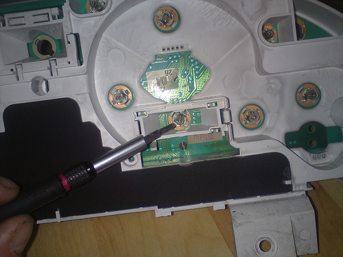

now you will see the the black module held on by further clips , ease them off with a screw driver and post the led module into the gap below its housing
next split the white part 4 more clips and it hinges apart releasing the printed circuit with the led attached ( or not)

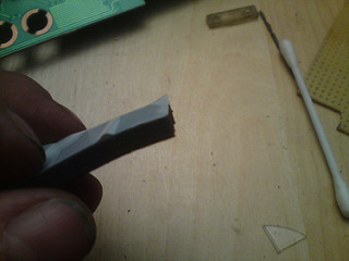

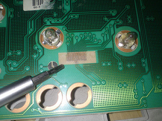

you now have to clear any residue from the bonding process polish the copper traces with scotch bite or the like in the direction of the tracks. 3M the manufacturers of the ribbon state the correct process to clear the residue from the ribbon - a cotton bud soaked in acetone free brake cleaner worked wonders.
DSC00496 by Sean602, on Flickr
you can do as i did and test it all now , plug the board in to the loom turn on ignition and with a finger hold the face of the ribbon on the board to see if you can get contact and cells going clear, as I discovered it just needs the slightest of pressure to make good contact.

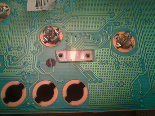

Now you have to cut a piece of plastic (i tried old PCB and thicker plastic but found a piece of CD case perfect) cut it to the same size as the un printed part of the board. Cut away the bottom left corner to leave space for the reset pin. While holding this piece in place drill both the plate and the board 1.5mm outside of the outermost copper tracks ( the outer tracks are un used so dont worry about damage) I used a 1mm drill for the small self tapping screws i had left over from a maplins box then drilled the plastic to 1.5mm clearance hole .
holes and plate by Sean602, on Flickr

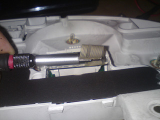

You need an even and gentle pressure this wont happen if you just clamp down the plastic on the board. I used a small piece of sticky backed foam
DSC00499 by Sean602, on Flickr

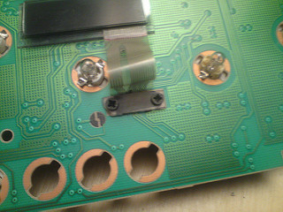

a bit rubber band cut and glued between the screws would probably work, then its back out to the vehicle , hook it all up place the ribbon under the clamp and fiddle about till you see all the cells working,hold the ribbon and tighten down the clip.
screwed down by Sean602, on Flickr

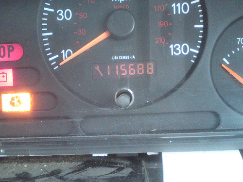

back to the bench and re assemble the dash, take care plugging the clocks into the PCB you have toget all the long pins into their sockets and they are easily bent.Its best if the board is loose in the white housing till its all in. Re fit and - bobs yer uncle (then panick about the miles you have done and remind yourself to get a timing belt kit on order)

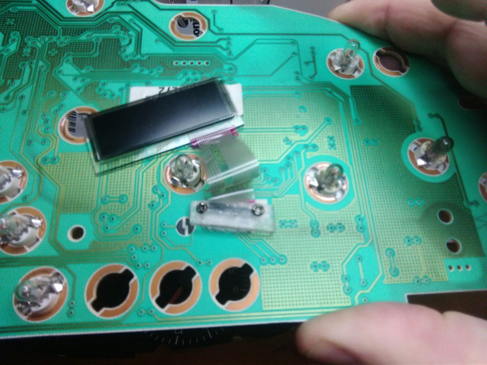

I have had this exact same issue with my odometer LCD, it stopped illuminating back in October(2021), on my 2002 Peugeot Expert van (1.9D).
Thank you for sharing your pictures and steps taken to fix this issue, I didn't find much else about this issue online. This has greatly helped me to fix mine.
At first when I saw the LCD ribbon had come off the board and before I found your post, I thought I'd have to replace the instrument cluster. So I headed online and had a look for one, surprisingly there wasn't many for the years I needed and the cheapest I found on eBay was £200 plus shipping :shock: sod that, plus the recorded mileage is recorded on the circuit board so replacing it would show mileage from another vehicle.
In my case I didn't have a suitable solvent to hand to clean the copper strips, so I carefully, under a magnifying desk lamp, cleaned off the glue using the tip of a carpet blade.
I made a clamp just like you did and using a piece of inner tube rubber with a piece of packaging foam which I glued to the rubber and when dry placed it under the clamp and tightened down the screws to the circuit board. This worked perfectly for me. I also trimmed the edge of the clamp to leave room for the reset pin, not shown in my image.
I went through all the dash bulbs to see what was working and what was blown and I had seven blown bulbs which I have now replaced and the display is like a brand new twenty year old display.
2002 Peugeot Expert LCD Odometer ribbon fix to circuit board
