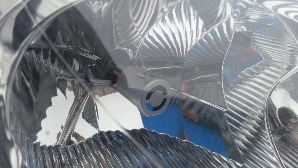

OK I got the new D2R ulb today ... fitted on and it still does not light up ... the old one "philips" was broken.
Now does this mean it is it he Ballast? or a Fuse?
Where is the Ballast located is it in the headlight?
By the way replacing the bulb was a pig! ... well kind of needed to remove the battery to gain access :(
