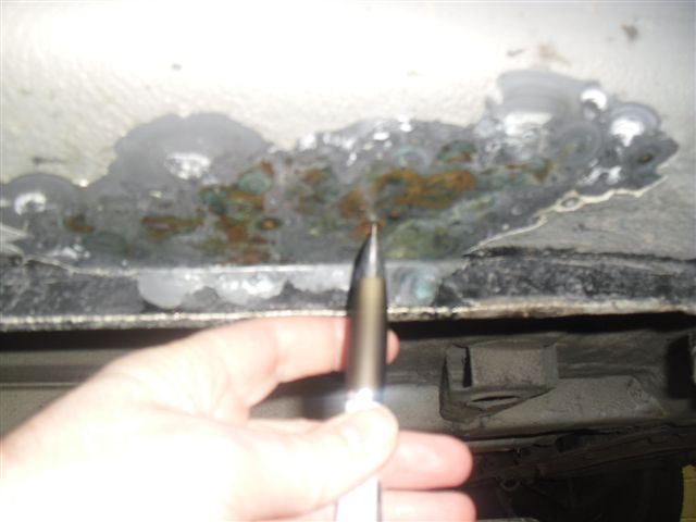

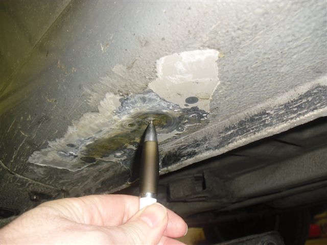

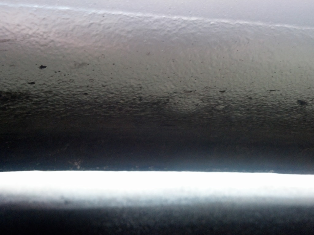

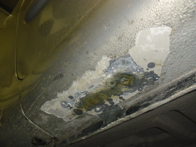

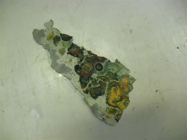

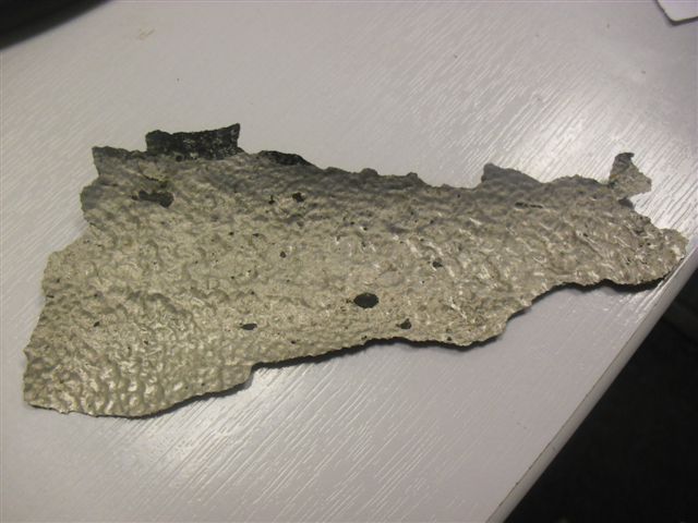

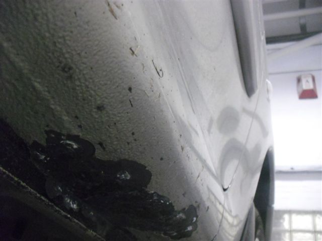

I have attached a few pictures I've been sent by the dealer, they have the ones of the car before the underseal was removed and there wasn't any rust staining at all underneath the car.
The corrosion has to be from the inside out, despite the corrosion being hidden by the seemingly ‘intact’ underseal, it isn't corroding from inside out, they're saying it has rusted between the underseal and the metal and that isn't the same.
From the off it appears, the materials used as protection in that area, wouldn't be up to the job and were destined to fail.
The corrosion is between the sill and the underseal ( the underseal that hides this very well, no external signs under visible inspection) and not from the inside of the sill, yet it has a hole in both sills with no evidence of rust staining on the outside of the underseal. This hasn't happened overnight and has been quietly rusting undetected for a few years now; maybe a few of the last ones are just starting, so nowhere near the 12 years that Citroen boast.

This one has a small blister on it, the rest of the sill is crunchy, there is no rust staining on it so it appears, to the eye to be sealed to the outside world. The camera didn't pick up the other examples but the sills were softer to the touch.

Exactly the same problem occurred in Xantia estates and also I would think, is a common reason for XM sills going...
I've seen several Xantia estates with big bubbles in the sill coating and when pricked are full of water with rust underneath..
The coating must be porous.
Best advice is to get the old sill coating off, de-rust and repaint with decent stuff..
And then fill the sills with cavity wax.

I'm sure it's inside to outside, and is a common Picasso problem. By the time I realised ours was bad on the NS I knocked a hole in it about 3" wide and best part of a foot long - the underseal was detached all the way to the B post, and the bottom of the sill was thin all the way along. It was only 7 years old :shock: OS showed no signs at all. I just got a plate welded over the op of it and undersealed - not pretty, but 'cost effective'!!

I have welded up quite a few Picasso,s with this problem, it is certainly from the inside out, and you can spot the ones with the issues easily , by looking for bubbles in the stone chip material. I have done a few reasonably late cars, its a real shame because otherwise Picassos are very reliable cars .
