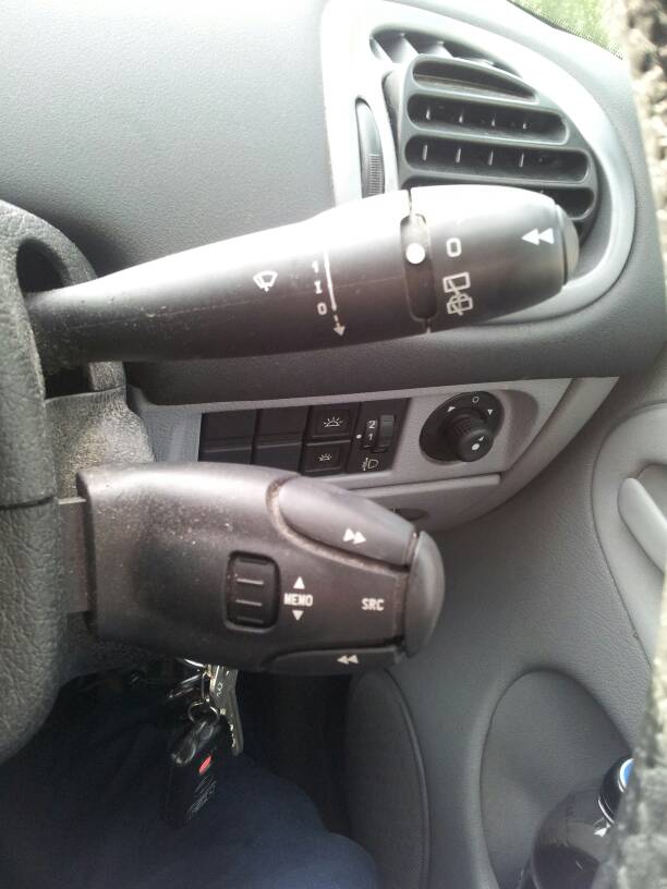

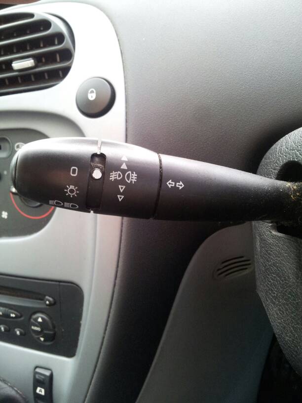

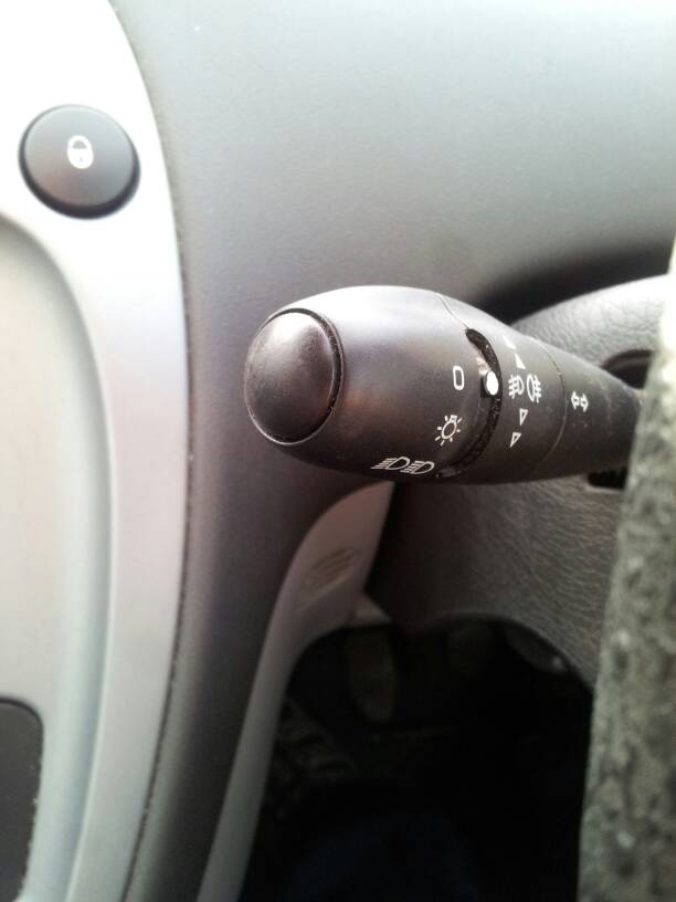

Added pics below as my stalks don't have auto lights. Is there a site somewhere that will tell me what other vehicles had that unit fitted? Maybe I can cross reference like we used to with filters many moons ago.
Again, thanks for any suggestions and please don't worry about offending me if I'm being a prat, I'm in such a rush I'm probably missing really obvious stuff!

Re: Part number indentification help if possible please
Unread post by citronut »
the only citroen model showing on service citroen with an all families search is
"1 document(s) found for XSARA PICASSO"
i havent checked pug service box as yet, but there may well be a pug uses the same unit
