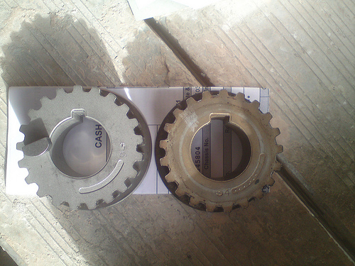

UPDATE
Well seems Ronnie and Malcolm both right. original pinion wide keyway presumably to make assembly easier. Replacement comes with a tight keyway presumably stopping dullards like us messing up the engine - photos uploaded later.
UPDATE

original bronze coloured Pinion, and new silver coloured part No 0513 A2
DSC00490 by Sean602, on Flickr

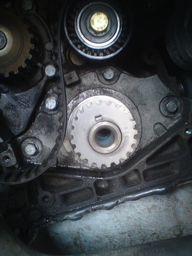

in situ
DSC00491 by Sean602, on Flickr
