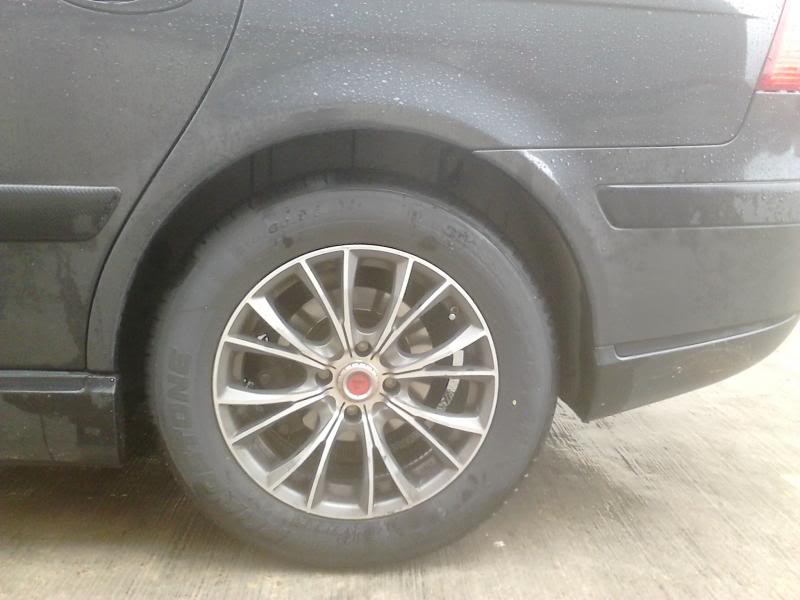

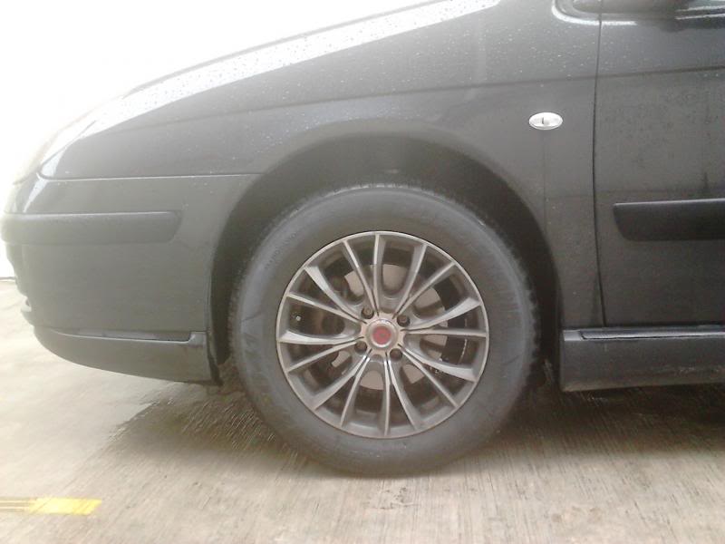

Re: Tyre, too wide, too tall or too narrow for my C5 II?
Hi all,
Please refer the following links to view the pics after installing 215/60R16 tyres (Took the pics after a downpour):
Thank you very much to all for the concern.
Regards,
