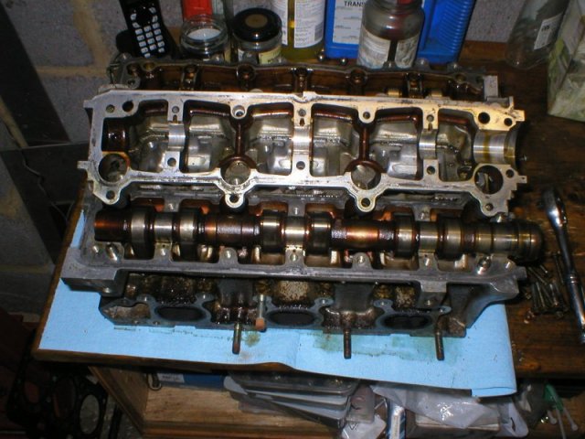

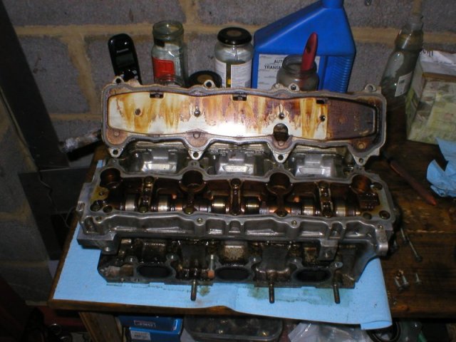

Mike, that's an excellent description of the job.. I'm not going to add anything except to offer the following pictures to illustrate some aspects of the job...
The cambox lid showing the integral (and reusable) sealing bead:
The cam ladder removed allowing the camshaft to be removed and exposing the lower jointing surface...

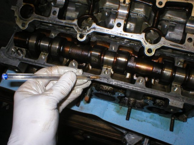

And a close-up of the sealant groove...
It is absolutely vital to clean every last trace of the old sealant from this groove and make it spotlessly clean. Then all you need is a very tiny bead of new sealant. Too much and the seal will not be good...

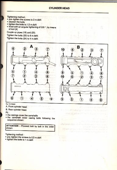

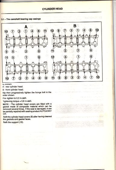

Forgot to add this info on cam cover tightening sequence and torque settings
and cam ladder tightening sequences and torque settings.
Both of which are pretty critical and important I believe..
