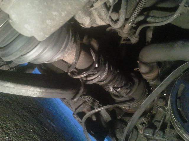

Jacked the front up slightly, removed the wheel arch liner, and not only did I find a shred of belt jammed between the altinator pully and body, which I manged to remove, I ALSO found the following under the car:
:-D
YES, thats the aux belt on the drive shaft!!!
So after half an hour unwrapping the belt, I fitted the new one, tensioned it up, and ran the engine, at a fast idle (3k) for 3 mins, then re checked he belt, all looked ok..
Not sure why it happened, though I cant remember for the life of me if I ever changed the older oil saturated belt or not.

Mine melted in France and it turned out the alternator was partly seized with the bearings collapsing. I suppose similar could happen if the pump had a problem
I hope you could see well enough to check that the belt hasn't damaged any seals or gaiters on that shaft. It's not unknown to straw to get wrapped around prop or driveshafts and get in past the seals.

i spoz the drive shaft caught it and stoped it getting in behind the cam covers then,
i still would whip the cam belt covers off the make sure non got in there
