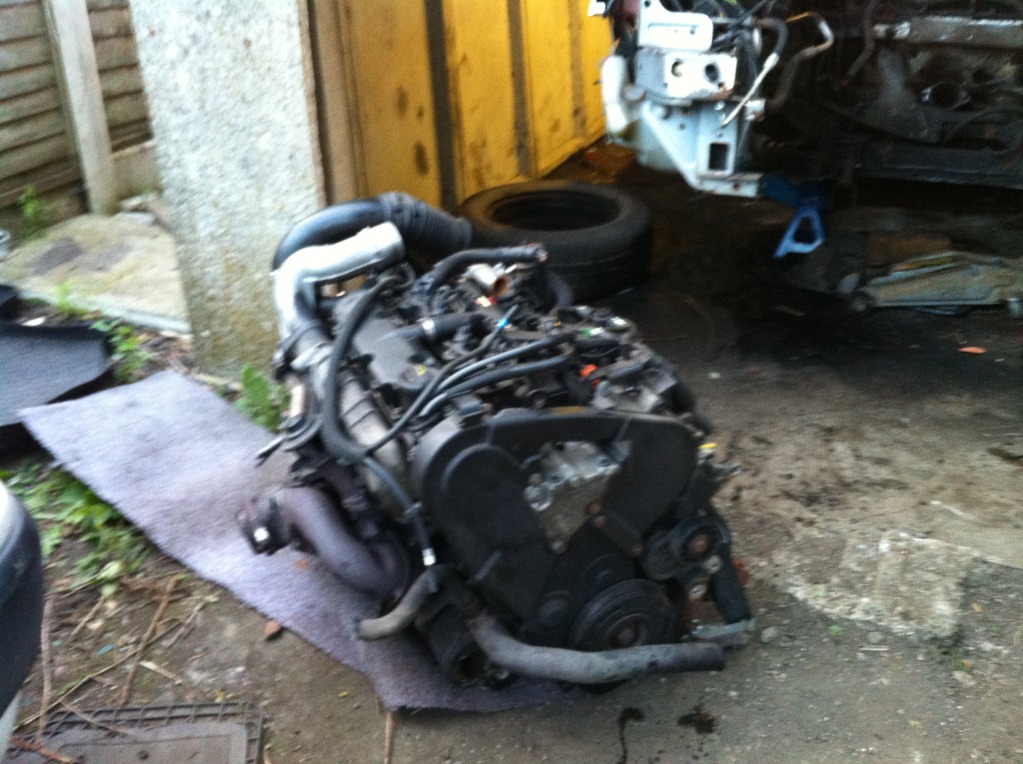

If you are after an Hdi 110 Alternator, I have one in the shed (I think) if its any help.
Actually its still on the entire engine and gearbox that I removed from the car, so hopefully should not be that much of an issue to remove.
Get back to me, if I can help.
- Dave -
- Dave -
