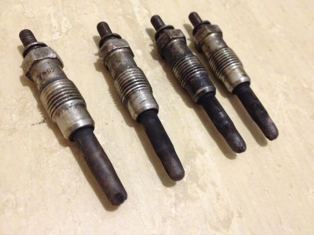

WOOOHOOOO! i did it, I did it!!! Thank you all for your advice!... Cranked 12mm, Plus Gas, broken knuckles!!! But no dropped nuts, no, not even the 8mm's! couldnt get number 2's 8 8mm nut on for toffee, but i forced my hand in there reallllllllllly hard and after a lot of twiddling and panicking it took a bite and the rest, as they say, is history! After being a pig to start since we got it it now starts after a couple of cranks, with no Uncle Buclk esque Smoke Plooms rolling up the street!!! So new air filter in tomorrow and then on with running through the 50 litres of dinosaur juice and half bottle of redex through it =)
When I took the old plugs out 2,3 & 4 were all black and sootie, but 1 looked relatively clean.. is that something I should be concerned about?
Again, thanks for all your help! Next job, blower motor.....

you certainly got your moneys worth out of them there plugs, if you havent already connect them one at a time across a car battery, be carefull not to touch the HOT end :-D :wink:
also use a heavy gauge cable elss it will melt in you fingers :shock: :wink:
i use a length of wire probably a 1/4" of an inch tick with a large crocodile clip at one end, put the crock on the body off the plug and hold the end of the wire onto the negative of the battery, and touch the threaded ens of the plug onto the positive terminal
although looking at them at least three are dead as the tips are eaten away
Regards, malcolm.

I'll give that a go tonight. I should have plenty of suitable (he says!!!!) clips n cables lying aroung at home.... I think it would be prudent of me to do the old check to see if the plugs are turning off when they are supposed to aswell, I dont fancy changing them again in the near future!!!!
