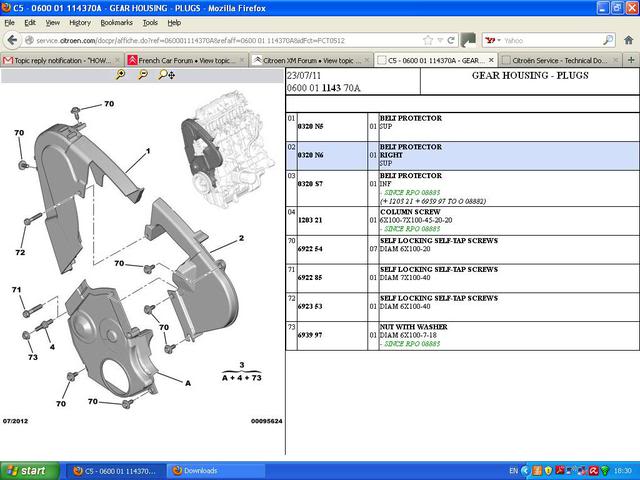

Here Peter, I copied the picture to Desktop then into paint, then uploaded it to photo bucket, and then here...
Thats an actual C5 parts list, not a Xantia one, but shows all the fixings...
Ive a feeling screw 71 needs slackening as I think it clips the upper cover on a C fixing not a hole fixing..

I thought you would know, screw 70 by the plastic moulding must be the one but I'm blowed if I can find it. I have had it jacked right up and lowered right down, the engine comes fairly well forward when its lowered and I have looked with a mirror and felt all the way down but I am obviously missing it for some reason, I will have another go tommorrow, got frozen out there today. I think I have got the rest of bolts out as the other covers are loose.
Thanks
Thanks

Don't think you can see it Peter - IIRC it's on an 'extension' to the cover (similar to the top bolt) on the engine side, with a web top and bottom. You can reach round the side of the engine and get a finger on it - it's much easier to spin it out if you've got a ratchet spanner.

Well I found it today, thanks Paul and Richard for the info. The sun was shining right into the engine compartment and I could just see it, but its so far away from the cover it doesn't look as though it belongs to it.
