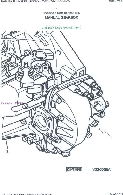

Would the filler be the one arrowed in this picture? If it is I was looking in completely the wrong place.
Thanks again

Posts: 55013
x 8343
That looks about it...
One has been known to cheat in the past and drain it and refill 1.8 litres through the reverse switch hole after removing it. It's just a tad more accessible.
Refill with 75W/80 oil and nothing else...

Well after 4 attempts I've finally got the oil change done.
Thanks for your help guys.
I tried to use the reverse switch hole, certainly looks a lot easier, but none of my sockets would fit, seems to require a long reach 21mm? socket. So I used the funnel and tube method, using the filling tube from the bottle taped to the end of a 1m plastic tube taped to a funnel with gaffa tape... now stored in a safe place ready for next year!
