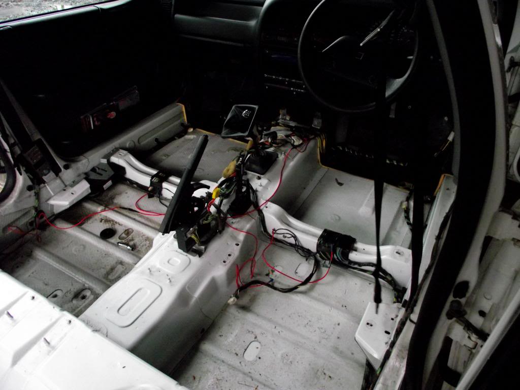

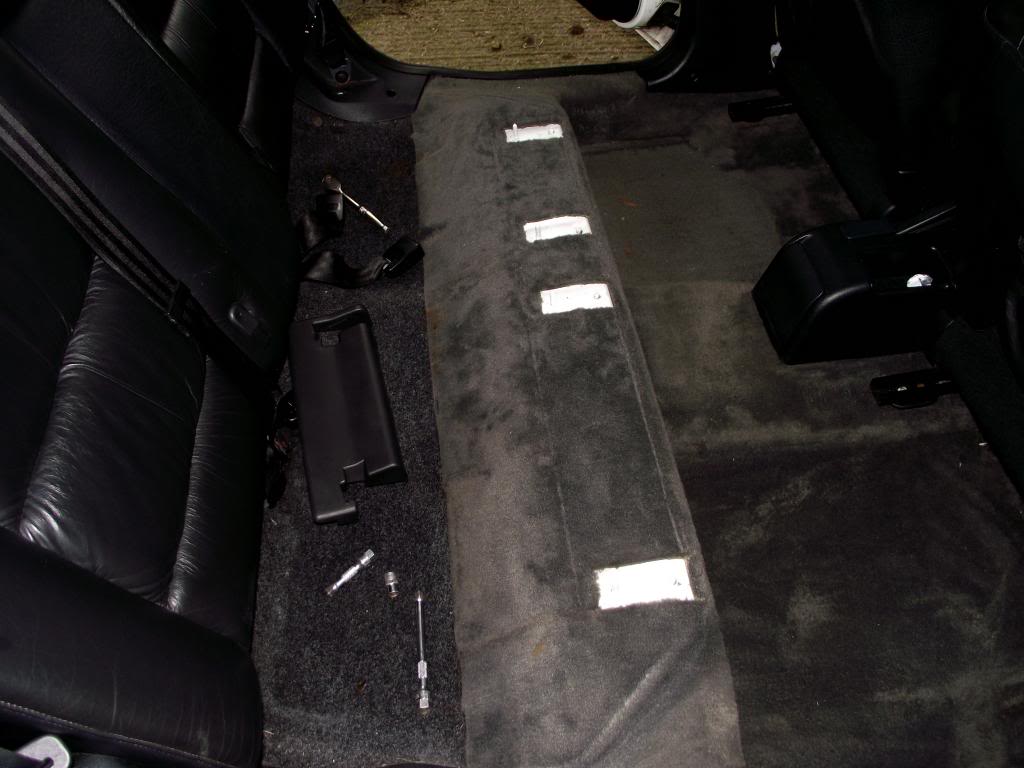

So started the job today. I removed the seats and carpets including the side trims and carpet in the boot.
Some pictures below:
Rear seat bases removed
All seats out
All carpets out

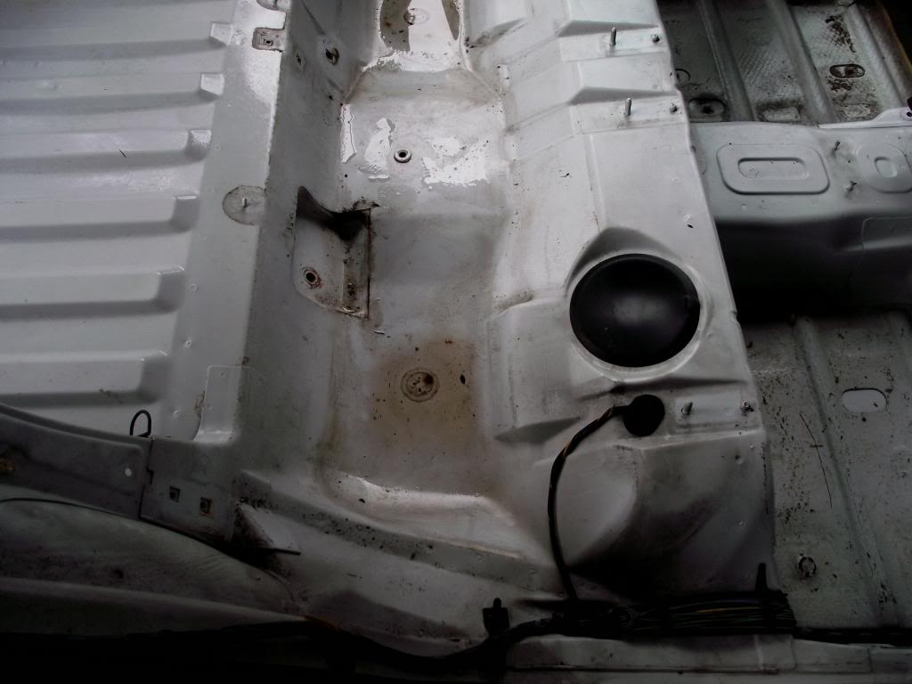

Water sitting in the wells below the rear seat bases
The boot sound deadening was absolutely sopping so I'm pretty sure the leak is into the boot area and it's then running down into the rear seat base area and the footwell.

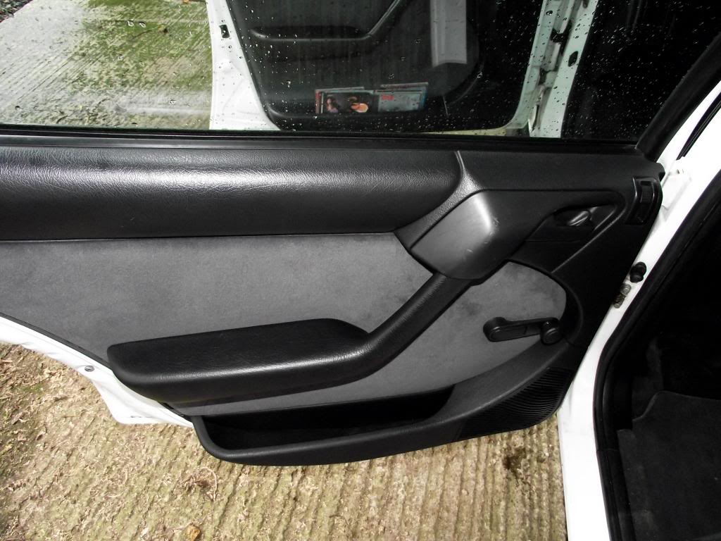

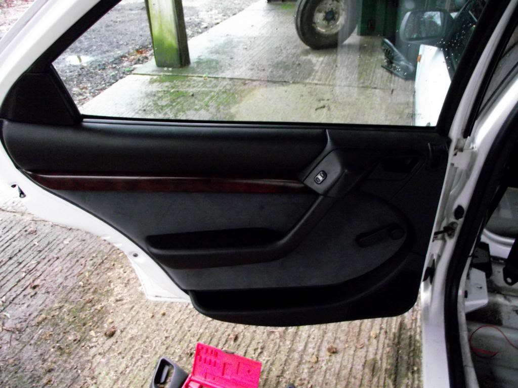

I fitted one of the new door panels to the near side rear.
Before:
After:

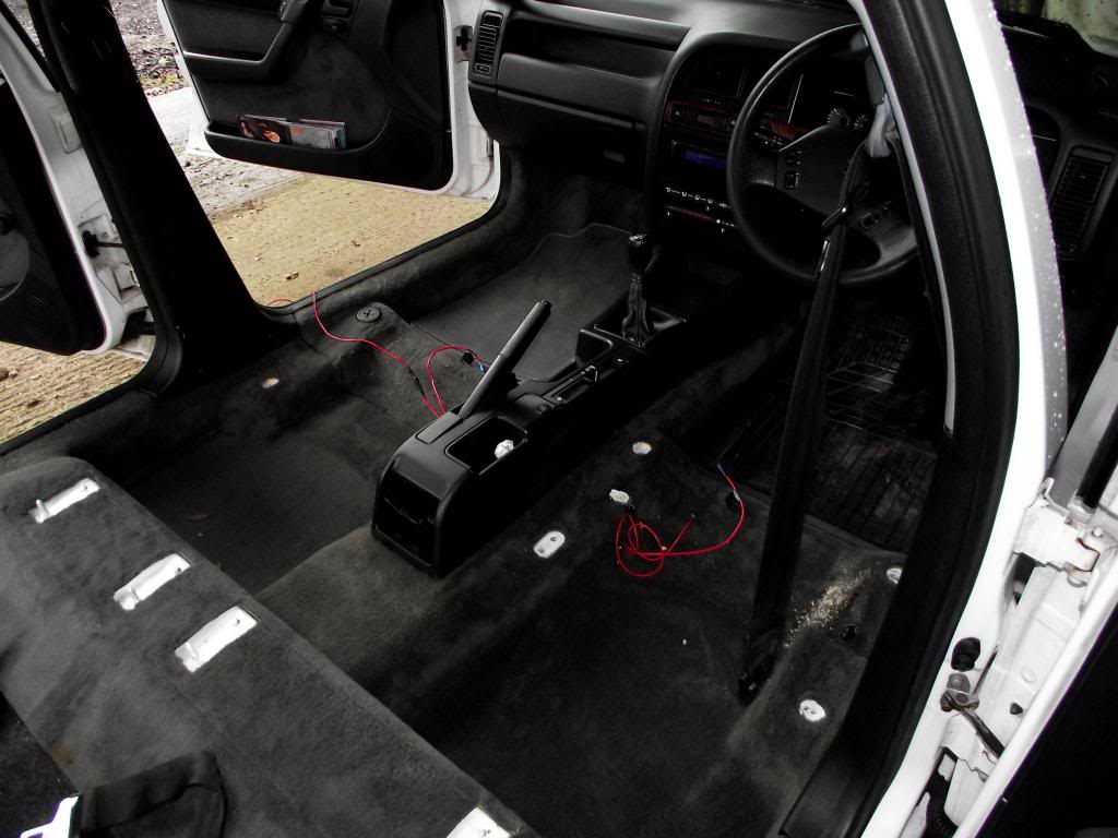

The carpets are currently hung up inside to dry out. Next job is to locate and fix the leak.
