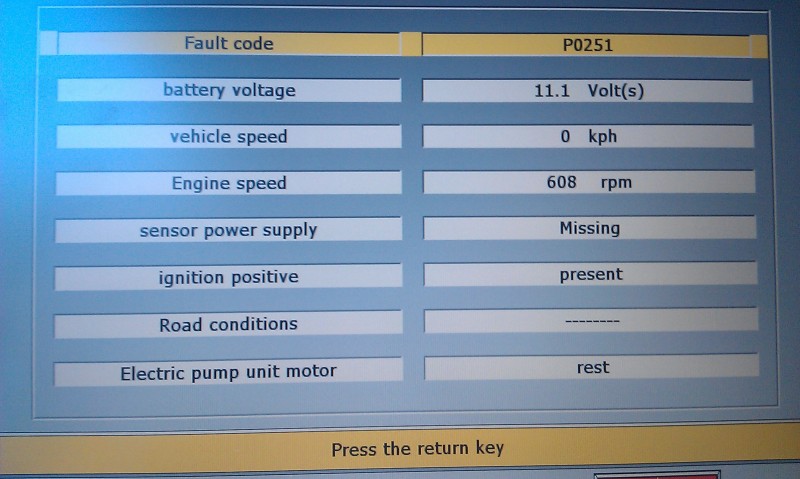

I went over to see Simon and his C5 today to see if I could shed any light on this with the Lexia, here is our findings:
These are the fault codes stored in the suspension ECU:
The top code opens with:
Note the sensor power supply: Missing
All codes could be deleted however the first two restore on start up.
The front and rear electrovalve operations are not controlable with the Lexia, they should be.
The front could be lowered with the lexia but would not pump back up. The rear only dropped slightly when asked by the Lexia to lower. After a while the suspension pump came to life and restored the car to full height again, but the pump could not be operated with the Lexia and did not function again after going back to high.
The car does not react at all to the interior suspension level button, it just keeps flashing up the high level and 6mph speed restriction.
It would seem to me that the open circuit fault is a result of wiring or potentially a faulty electrovalve, but not for them both to not function?

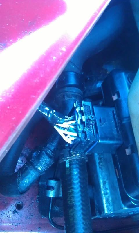

The wiring loom to the suspension ECU has been taken from another car, the garage claim that car had more "suspesion spec" so I asume its from a fully hydractive + C5. The garage then patched the wires to this new loon/plug to plug into the ECU. However, there are at least four wires which are not connected and are simply snipped at the plug. While this might appear to be the fault, is it?
Does a H3+ have more wiring to the ECU?
I wonder if the ECU could be from a H3+?
Does anyone know of a wiring diagram for this plug?
The first ECU apparently kept the pump running (probably the cause of the fire) but after the new wiring it could reach all suspension levels and was working fine ... im not sure, if it is a wiring fault ... . The ECU which is fitted now apparently did work until it raised to full height and wouldnt move.
The garage is confident it is wired in correctly but is it ...
Here is the plug, you can see the 'spare' 4 wires which are snipped off.
Has anyone got any ideas on this? Im thinking the wiring still needs work
