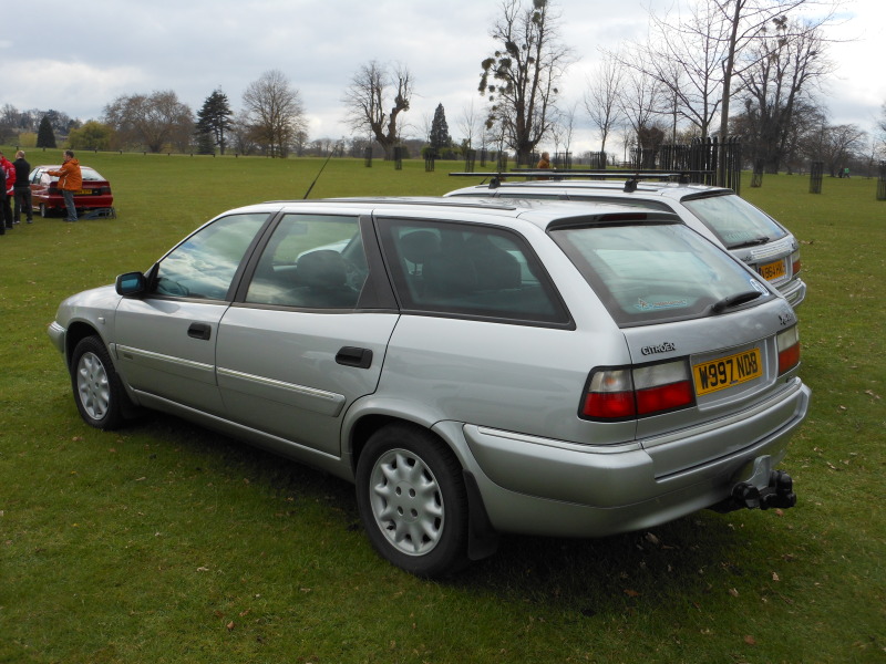

Andrew, were you at the X Rally last year with a silver HDI Exclusive estate? This one:
If so, I was very taken with your car, its in great condition and really gave me a taste for an Exclusive HDi Estate. Which, thanks to Richard, I eventually found.

Yes, the silver estate, W997 NDB is my everyday Xantia. If not the best car Citroen ever made, certainly the one most suited to daily use in 2013.......
