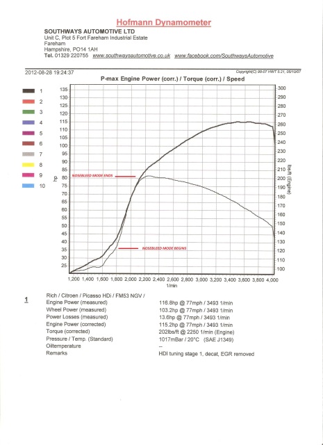

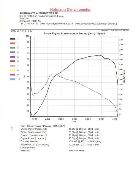

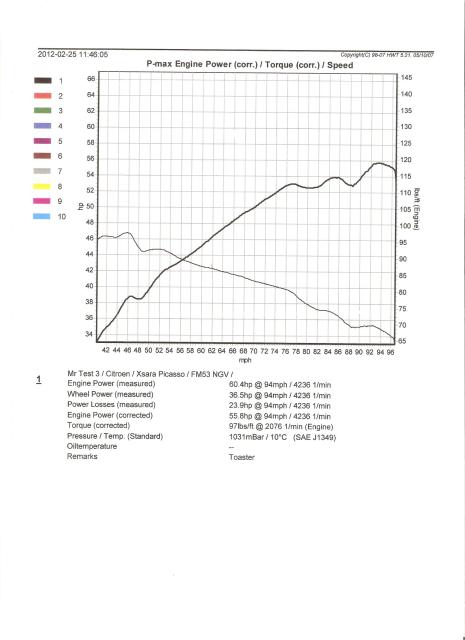

Anyway, here's my Picasso on the dyno with the aforementioned issue:
Here it is, with new AFM:
And here it is now:
well it would be if the remap hadn't eaten the clutch
