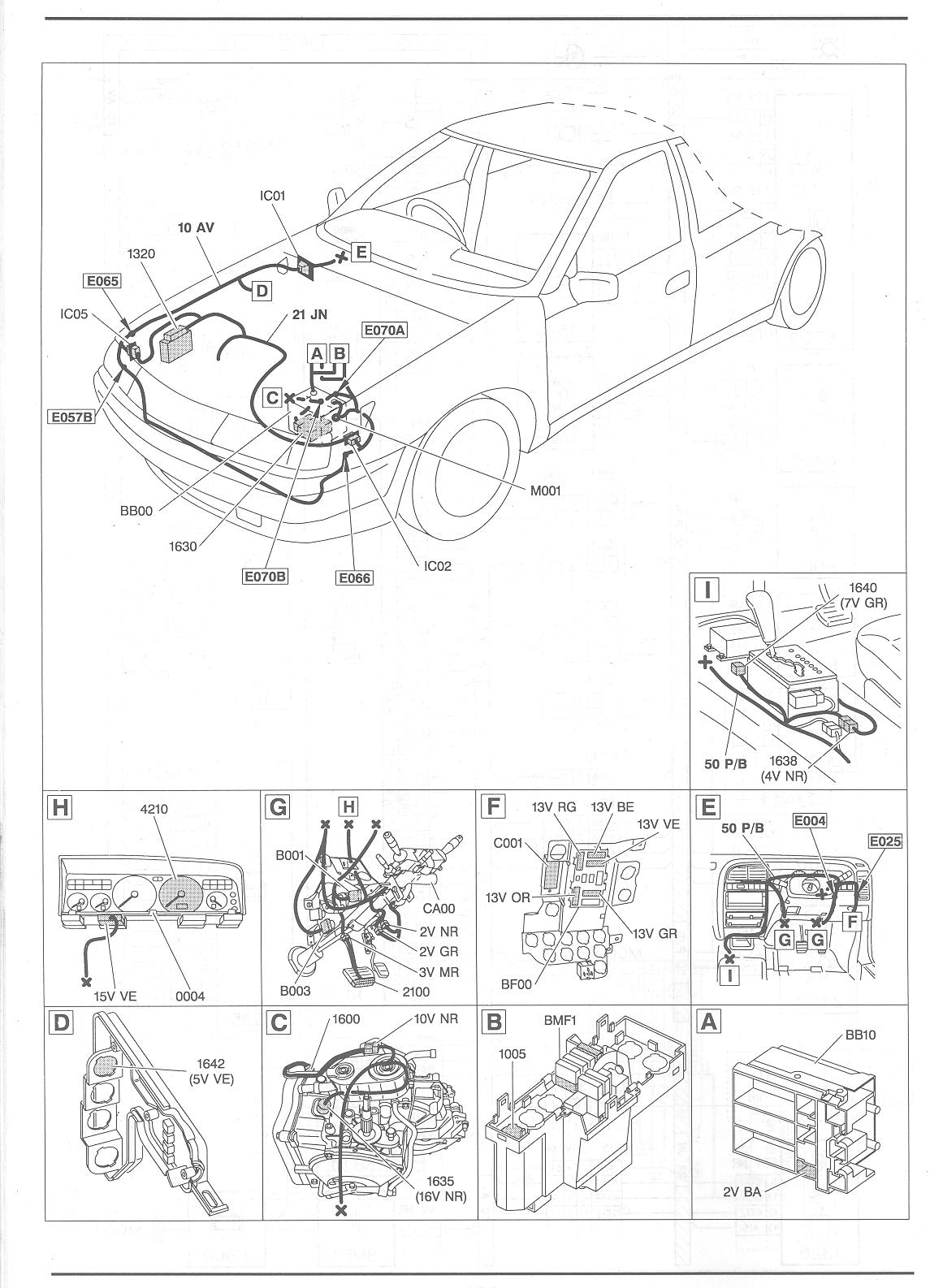

Dunk, I believe the is car has done this before. Not for may years now but I remember her ex-owner having a similar issue and it was down to a blown fuse but no reason could ever be pinned down as to why... Maybe Mike will tell us more. Definitely worth doing a fuse check hough..
Here is the circuit of the auto gearbox including selector switch and park lock solenoid (item 1638)
And here's the harness and location diagrams to go with the above...
Hope that helps to fix and if you need any other wiring diagrams to chase this down then please let me know...
