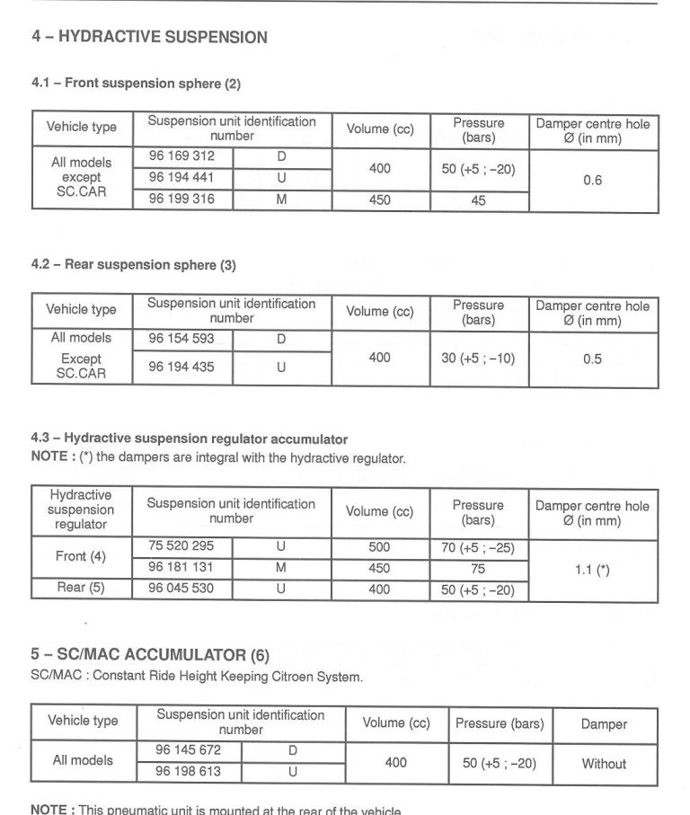

Paul, the main accumulator attached to the gearbox should be a 62bar/400cc sphere and is common right across everything..
The lower sphere he mentioned, almost under the radiator is the hydractive centre sphere for the front suspension and this one controls ride softness in soft mode. they do have a habit of either being absolutely perfect or ruptured...
This sphere is an accumulator-type (i.e. not internal damping elements) but is 70bar/500cc or 75bar/450cc if it has a multi-layer diaphragm...
If it's flat or ruptured the front will feel incredibly stiff...
There's a hydractive centre at the rear too and again if that's flat it can make the rear very hard...
Here's a list of hydractive sphere specifications

You've more than likely got a 500cm sphere on there whereas I believe later Xantia's were originally specified with a 450cm, I'd be very surprised if you could notice any difference between the two, I've run Hydractive Xantia's with the larger (500cm) centre sphere for years without an issue, I wouldn't worry about it Paul. I believe GSF normally supply the 500 sphere for this purpose as a matter of course.

Thanks for that guys. So as a suspension sphere the gsf one is as close to the spec as makes no difference, and as the main accumulator sphere it has a larger capacity and higher pressure than spec but this is irrelevant as the pressure regulator does exactly that, I guess it will tick less often than spec but is this a bad thing?
