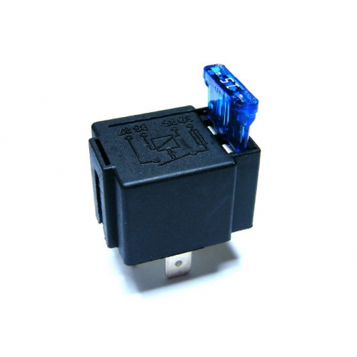

Not got a clue as to the mod needed on the xantia? but un fused and full power going through plasticky switches- a habit Citroen got in to looong time ago! Common mod on 2cv is to use these relaysIrfanIbrahim wrote:I'm definitely not an electrically-minded guy. Haha. If someone can provide enough information about relay spec, wiring spec, i'll try to find someone who knows how to do it.
keeps it all neat and tidy
