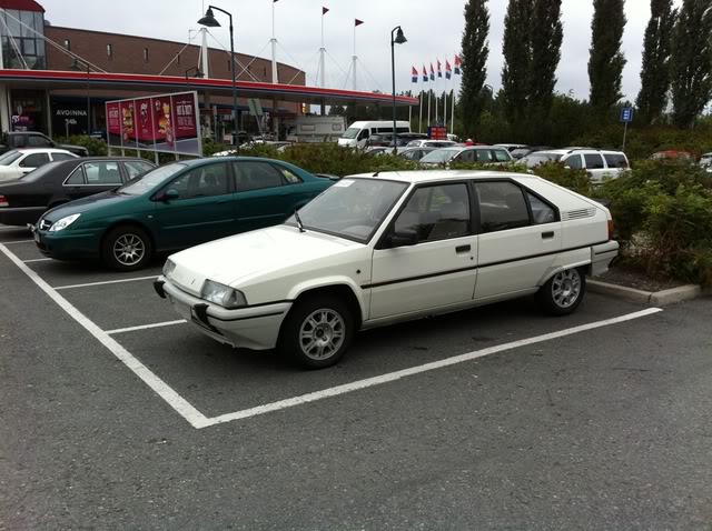

I bought an -89 BX with 1.4 TU engine, without any fancy electronics, shell was absolutely stunning! But I've always fancied a 16 valver, so I bought a rusty shell where i could take interior, engine etc.
Heres how it looked when I got it:

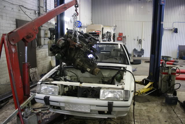

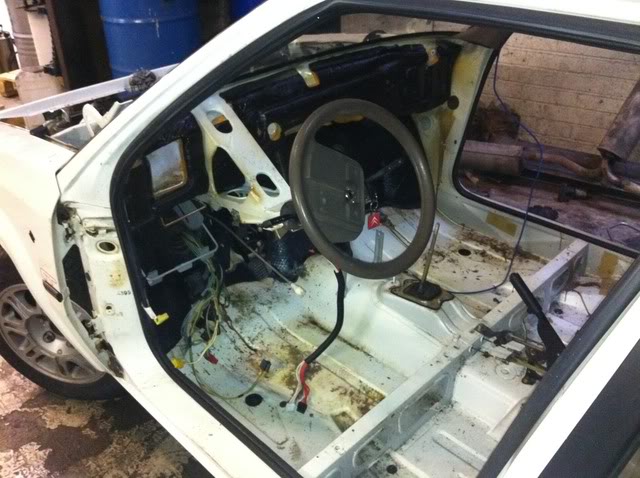

I stripped interior and other stuff so I could start getting it back together:

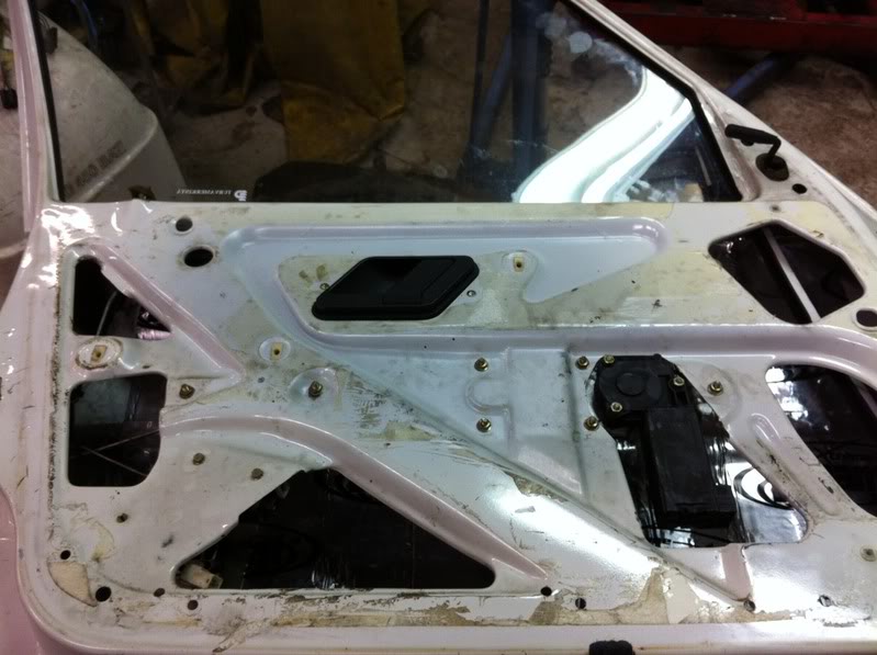

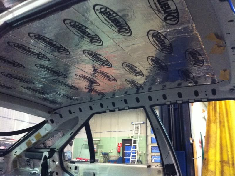

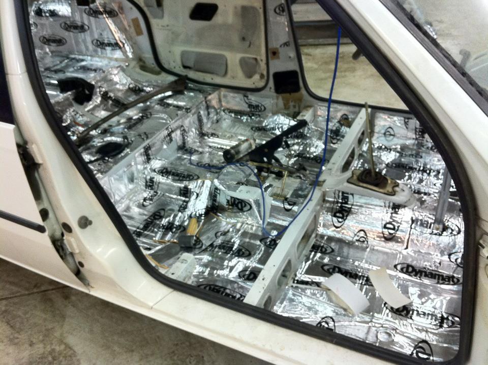

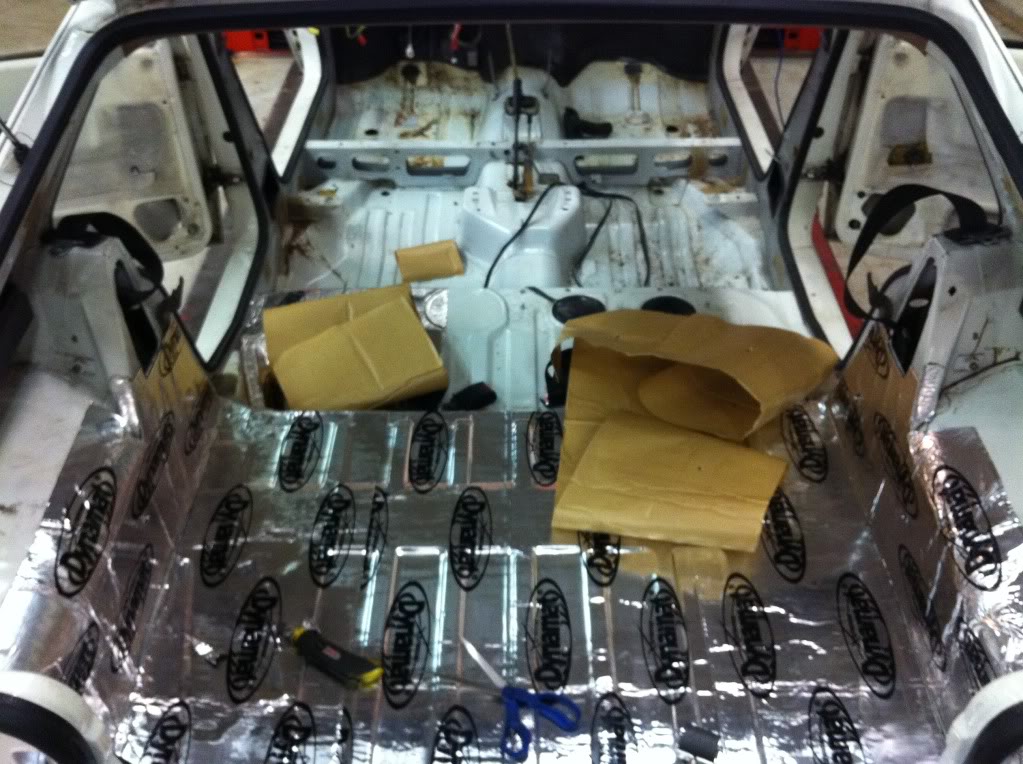

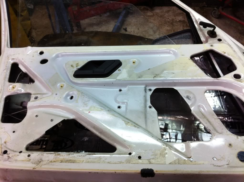

After I got everything stripped, I started doing some noise dampening:
Also electric windows and central locking found their place

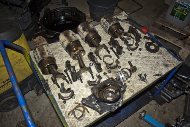

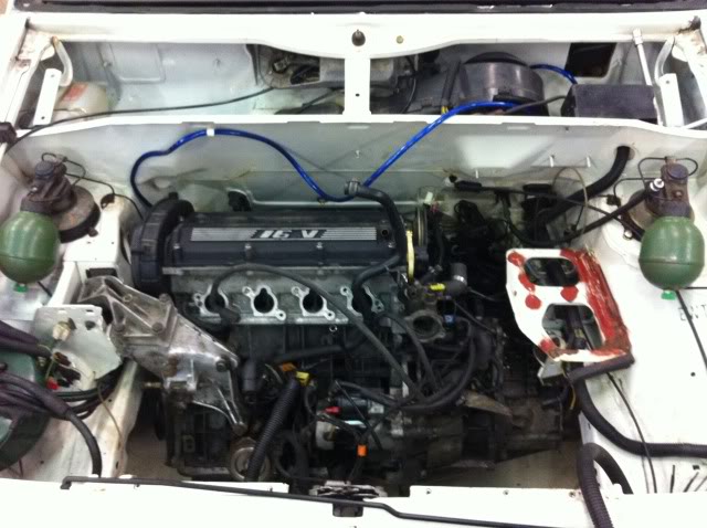

Engine got a full rebuild aswell (didn't paint anything tho :P )

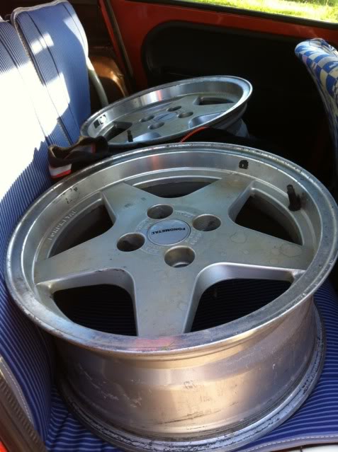

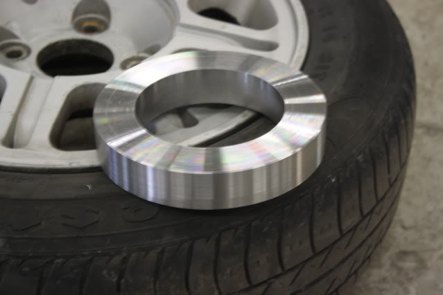

As it was getting "ready" i started to search for rims, luckily i found a set, Fondmetal 4000 in 15x7 size with et30 (i have 16mm spacers)

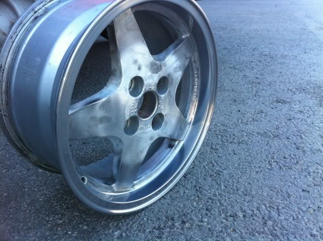

They werent looking good, so i decided to paint them and polish lip
Meanwhile i already had driven car a few weeks, so it was working well :)
A friend of mine painted the rims, pretty unusual colour ;)

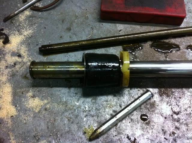

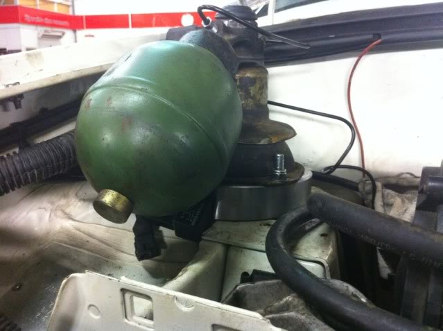

Modified front suspension a bit (original in pic, didn't take one from modified one)
As that -4cm i got from that modification wasn't enought:
Much better! :D

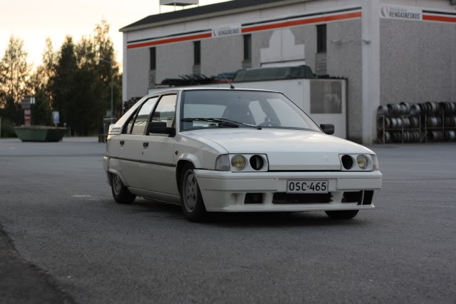

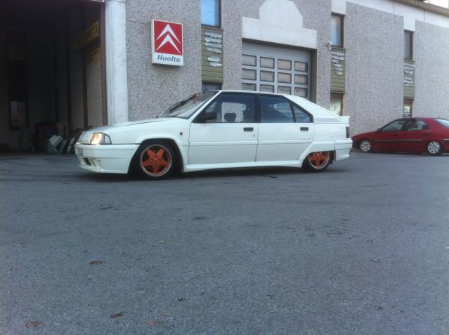

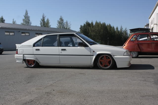

Current driving height is this:
At the moment im not driving it as of winter, but in the summer i'll start scratcing bottom of it..again..

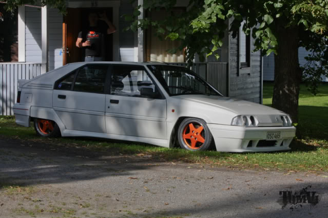

Latest modification i made for it was to paint front repeaters orange:
Currently morettes are getting "polished" so they're not on it right now.

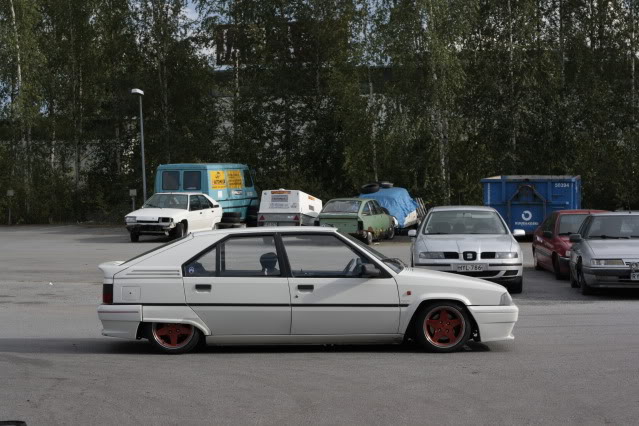

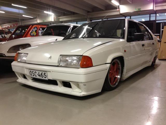

So here's where i got it :)
Ground clearance from front subframe to ground is 2cm in lowest position, driving height is about 5-6cm.

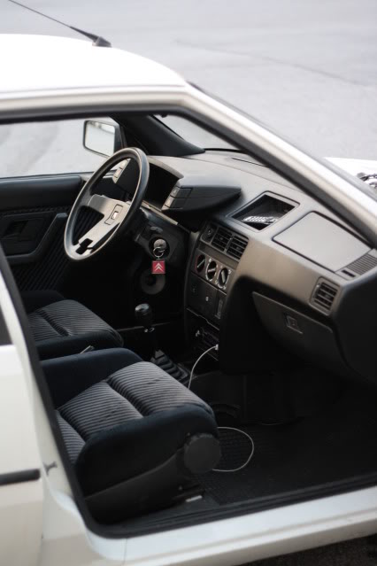

Very nice , is it a full 16v interior ? You certainly did a good job with the dynamat .
Mark
Jeth
Posts: 63
Joined: 02 Feb 2010, 16:28
x 1
Re: Project lowrider
Unread post by Jeth »
bxzx16v wrote:Very nice , is it a full 16v interior ? You certainly did a good job with the dynamat .
Mark
Yeah, full 16V one

Jeth wrote: Image
Looks like a nice car, this would concern me a little though; the strut should have the weight of the car on it, not.. pulling down on it in only three places; all those forces and weight on those bolts. of course I could be wrong.
Neil aka CGAT
1986 CX25 GTI TURBO 1 SERIES 2 'CGAT'
1998 XANTIA 19TD ESTATE
1987 BX19 GTI 8V
2012 Citroen DS3
1997 600 Bandit
2000 ZX12R from new
1989 CX GTI Turbo 62k miles in a barn since 2001, project started 2023.
Mandrake
Posts: 8692
Joined: 10 Apr 2005, 17:23
x 695
Unread post by Mandrake »
I quite agree. The bolts are only designed to locate the strut top not carry the load, the load is normally carried by the entire flange since the flange should be below the body pressing up on it.
Doesn't look like there are even any washers to spread the load a bit. :roll: The first judder bump that car hits at speed either the bolts will snap or it will tear out of the eyelets at the edge of the strut top frame. VERY dangerous and it shouldn't pass the MOT in that condition. :shock:
While I applaud most of the restoration work that has gone into the car I can't abide or understand the lowering of the suspension, apart from the safety issue with the strut tops the handling of the car is going to be completely compromised to the point where it is dangerous to drive at speed, which is a shame when the BX16v in standard spec arguably has pretty good handling. As with most lowering, its all for looks with no thought of actual handling or safe driving...

I agree hence my statement of being boring i chose not to make comment as Im usually the only one.. but the strut top positioning concerning the bolts never crossed my mind it was the ride or what there isn't left of it.. you might as well just of rotated the height correctors on the anti roll bars SOOOOOOOOOOO much less hassle..

Just another thought..... Is the rise and fall as it is being driven 'taking that the spheres are in good order' it will to be blunt, smash (-expletive removed-) out of it :)

CGATCX25GTITURBO wrote:Just another thought..... Is the rise and fall as it is being driven 'taking that the spheres are in good order' it will to be blunt, smash (-expletive removed-) out of it :)
:-D :-D thats a good point, they are long travel spheres, if they were in good order on a standard setup you can bounce the suspension along full travel... theres no room for that.. So, Flat spheres in use here too???
