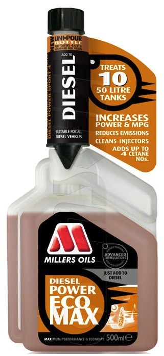

Will "Millers Diesel Power Ecomax" do the trick?oneday wrote:yes millers i use wynns egr intake cleaner and wynnes oil flush other makes also available as they say
2011 Renault Megane Sport Tourer 1.5 dCi 110 Expression+ Silver
oneday
- Posts: 663
- Joined: 15 Aug 2012, 22:49
Re: 2009 Citroen C5 1.6 HDI - DIY Full Service
yes thats what i use 1 bottle will treat about 10 full tanks
