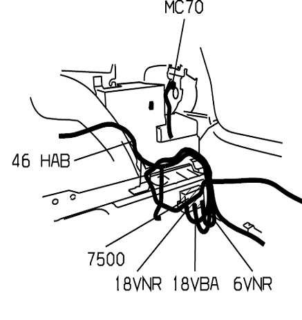

Sorry to drag up an old thread but can anyone tell me where the parking sensor ECU is on my car.
2010 (X7) 2.0HDi Estate. I've had a look behind the rear bumper but cannot see anything.
Thanks,
Gav.
Thanks,
Gav.
- x 6957
Re: 2009 C5 Parking Sensors question
Where the spare wheel is, to the right, mounted on the side, a black rectangular module easy to see.
That's what I thought from reading here but it is not there.GiveMeABreak wrote: 08 Mar 2021, 09:22 Where the spare wheel is, to the right, mounted on the side, a black rectangular module easy to see.
- x 6957
It may be on the inner right wing on the Tourer- look at item 7500 here:. That's the ECU

GavinPJ
- Posts: 48
- Joined: 27 Jul 2020, 09:12
- x 1
All sorted. 1 faulty rear parking sensor. Thanks guys.
