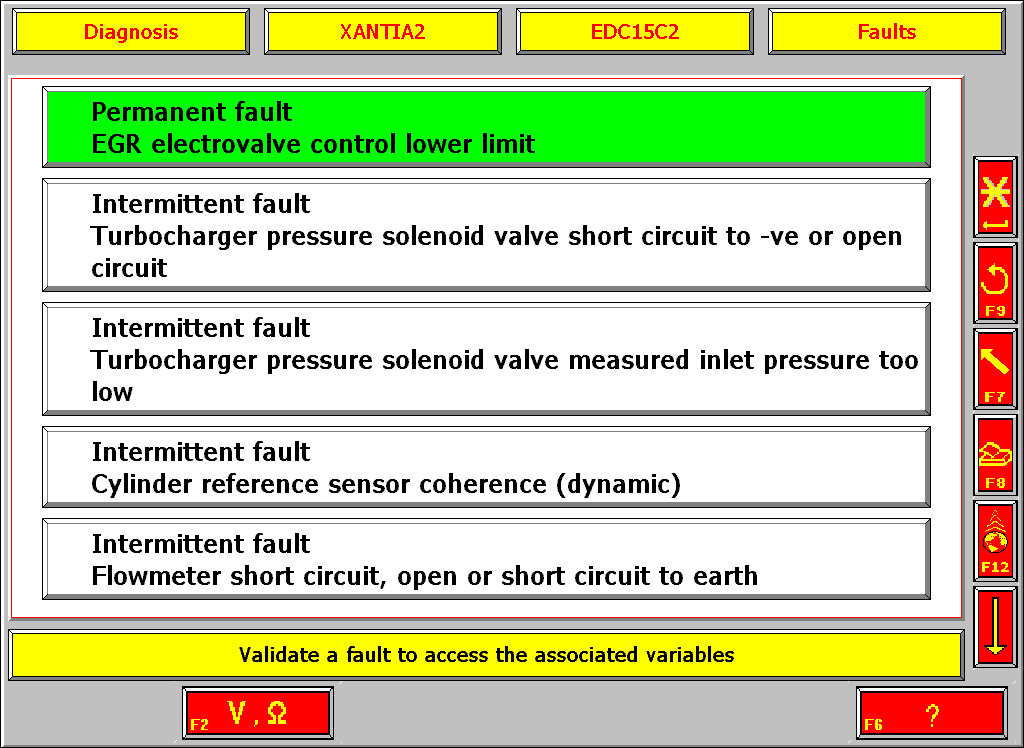

About 2 months ago i bought Xantia 2.0 HDI Activa (80kW, RHZ engine) - more or less is running fine...but
Occasionally the car doenst go as it should: first a little bit of hestitation then black smoke and everything feels OK.
Problem is not so noticable when cold, today was VERY annoying (we had about 10 degrees celsius).
On saturday Lexia showed some faults (1st pic), then i cleared all of them and done some driving yesterday. Today Lexia again showed fault: Permanent failure: EGR Electrovalve control lower limit (2nd pic). What does it mean? Is it faulty EGR Solenoid or maybe dirty EGR valve (stuck open or something)? Or both? I've done some tests - removed vacuum pipe from vacuum source to EGR Solenoid and blocked it. Hesisation and smoking seems to have gone but i'm still wondering ....

I guess the right answer is still EGR Solenoid. It is still disconnected (pipe, not electrically) and there is still no smoking and having VERY good performance.
I will also try to switch EGR and Turbo solenoid just for testing purpose and just to confirm that EGR solenoid id faulty. I hear this is quite common fault on 2.0 HDI with 80kw.

Update: last weekend car lost almost all power and torque
Lexia now said it is faulty MAF. It was some no-name Chinese cheap-s**t. Today I installed new one (original part, not copy) and ..... It's alive!
Also EGR connected back and all problems went away. Wheeee
