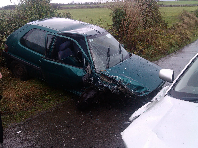

But TBH I don't feel safe in it. Yesterday I was chatting to a friend about that and he said a Saxo just crashed into his wifes car and showed me a pic... the Saxo had bent in half at the B pillar, so that made my mind up.

Here is the pic that made up my mind.
Avensis was stopped with wheels on verge of narrow road.
Saxo owner was fiddling with radio.
