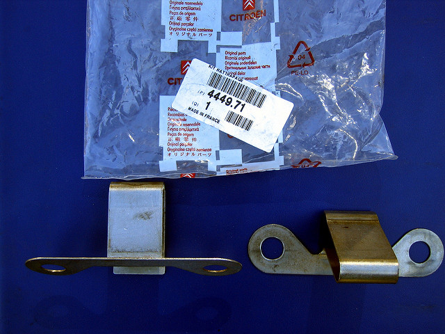

I just tried to buy as set of these for my current V6, which for some reason rattles more loudly than my previous car. Unfortunately the part is no longer available from Citroen. Was this part ever factory fitted to any other model (to have some chance of finding the second-hand)?

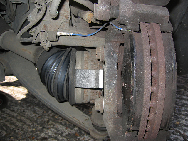

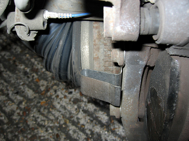

xantia_v6 wrote:The brakes fitted to V6s and HDI 110s have a poor design that makes the pads rattle loudly over rough surfaces, making the ride sound much worse than it is. There was a factory modification to adding some spring clips to quieten them down. Search around here and you should find some photos of the clips.
If you hear a rattle at the front end which sounds like a worn droplink gently pull up the handbrake enough to just tension the calipers as the car negotiates corrugations in the road surface, if the noise stops you have three options, put up with the noise, try "loading" the caliper as you tighten it or buy/fit the clips below.

Are there one or two springs in the "kit"?

Mike, I have a set of these on my V6... In fact i think the photos are of those on my car... We could always try fabricating a set from some suitable material. I don't see it as being particularly hard to do really...
