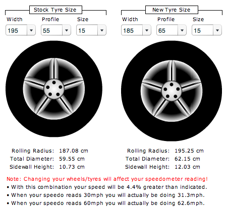

I've seen a couple of s1 VSX's running 185's - my father's 2.0i auto too where there's a real
opportunity to give even more ride comfort on the tyres with more depth on the sidewall:
watch you don't get camera'd in a average speed limit etc although it will depend on the
tolerance the camera uses...

My 1997 2.0i Auto VSX also came with 185/65/15 tyres - thats the original spec on many Xantias, check the tyre guide on the door card and you should see it posted there.davewithington wrote:Well I have my new Xantia
It has Michelins all round, in 185/65-15. I thought that all VSX cars had 195/55-15, with a 185/65 spare. Was this changed for the later Mk 1?
IMHO the 185 tyres are a bit undersized for a Hydractive 2 VSX model (even an auto) and they do benefit from bigger tyres if you like to push the car around corners a bit, which is where the Hydractive 2 really comes into its own. I changed mine to 205/60/15 Michelin XM1 on the original alloy rims and the cornering and handling limits were much better that the original size tyres with very little if any penalty in ride quality. (205/60/15 is actually a slightly taller sidewall than 185/65/15 not shorter)

As has already been said, you have the correct size tyres for your Xantias year and spec. however later cars did wear 205-60-15, which is what I would upgrade to if you need a full set.
