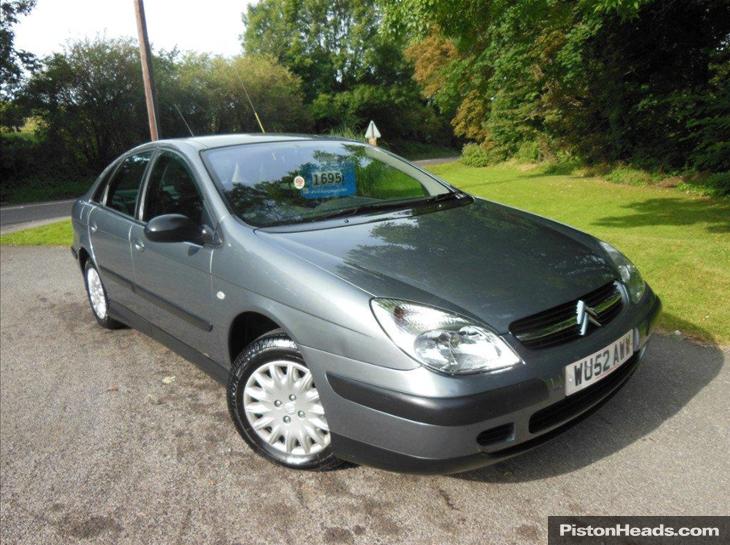

LX:

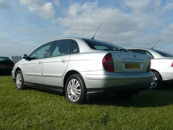

VTR:
If you want more performance get your current 2.0HDi 110 remapped or get a facelifted C5II with the 138bhp 2.0HDI.

That depends on how early or late an S1 C5 VTR it is. Usually 2003 cars have the manual controls of the LX. 2004 Cars have the dual zone climate as the SX. My previous C5 VTR, the silver 2004 pictured above, had dual zone climate.oneday wrote:the vtr doesnt have duel zone heating at least not on mine
VTR also has colour coded mirrors, as SX spec.

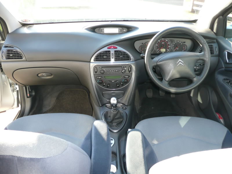

Here is my previous C5 VTR, a 2004 S1 with climate control:
I soon got rid of those mats!
Added cruise control to that too.
