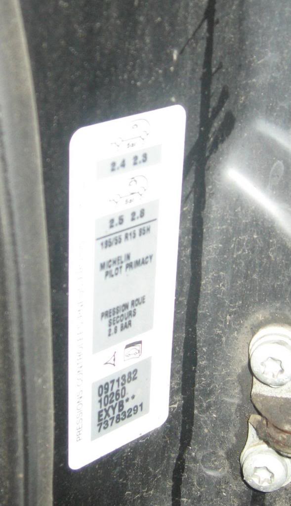

Just decode your RP number on the label on the A pillar. It used to be 4 digits but now 5.
This is mine, although it's a Xsara hatchback, not a picasso:
The RP number of my car is 9713 which is 13 June 2003. I know it was built then because when I ordered it the dealer couldn't find any in the colour and trim I wanted so I had to wait until it came from the factory.
There are various web pages which can convert RP numbers to dates. Citroen must have anticipated the 4 to 5 digit rollover as there is a zero at the start of mine.
I checked mine at this site and as long as you drop the leading zero for a 4 digit number, or enter a 5 digit number it seems to work well.
EDIT: That doesn't help OP does it. I should learn to read better. Tempted to delete but might be useful to someone..

I've had a look at the numbers and it appears to have been made on 31st of March 2004 it should help me to find parts
