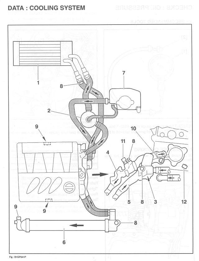

This is a diagram of the cooling system. the bubble-breaker is item2...
