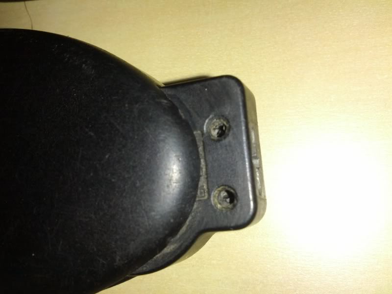

I removed the blade from the key fob ... now I need to go and cut a new one of my car's original key
I drilled the two little holes just a bit and the blade slided out.
