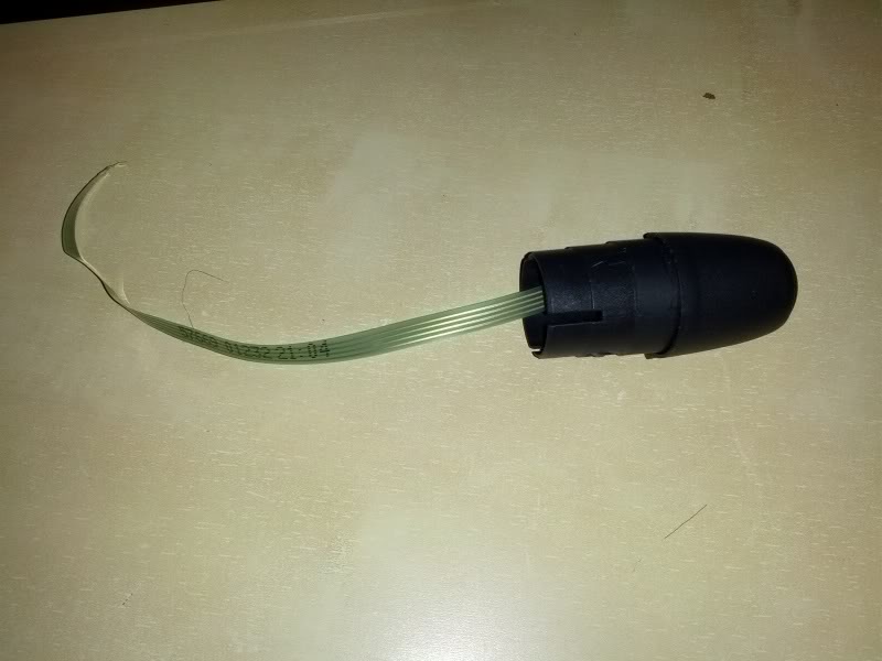

All the advice was more than helpful guys thank you! :) :) had to take the steering wheel /airbag and stalks 3 times until everything works to the satisfaction lol ... an expert on Steering wheel removal now lol lol
I disconnected the battery as stated in myglaren's post this was really helpful as well.
First time I re-sat the tape in the PCB .... but this was not working still.
The disassebled the button housing and found out the little metal contact was broken ... a quick trip to the local scrap yard and I got a (used) end of the stalk with the button and tape wiring.
I have removed the metal plate from the new one and installed it on my one ... put everything back together and ... still not working.
Removed the steering for the 3rd time and now I replaced all the inside mechanism of the button including the tape from the new one... and put all back together.
Everything is working perfect!! long day :) but all good when things working as they should be.
