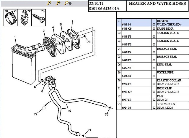

The fans/blowers have stopped working, and when they are switched on, there is a steady trickle of smoke/steam coming from the vents, from what I understand, this could be the heater matrix, however, there are 2 types...
I have tried numerous Google searches for a VIN, so I can find out which type it might be, and in all the ones I have tried, it has come back with an invalid check digit.
Is there any one here who can help verify my VIN, or at least point me in the right direction, so that I can find out which heater matrix I have?

mog wrote:... which heater matrix I have?...
I hope this helps. Just as an additional information, all the air conditioning parts seems to be Valeo in your car :)
I'll PM you a detailed tech. info of your car.
