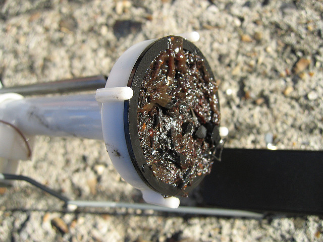

Well after a good few hours of tapping away at that plastic screwtop to the tank. That badboy was fixed well and good! Anyways it came off in one piece in the end and low and behold the mesh on the fuel sender was totally blocked up. Twas a miracle anything was getting through at all. I cleaned off the exterior gunk but couldn't see how to remove the gauze to clean the inside. So in the end I accepted those bits would get dragged and caught by the fuel filter, which i'll clean out tomorrow.CitroJim wrote:And also check the return fuel line back to the tank is clear... I've known them block up with lumps of congealed veg.
I didn't check the return pipe, didnt know about that, however the car drove better than it has done for ages. So i'm assuming that this has been a large part of the issue since the car has been run on veg. There's is a lesson there somewhere..
I floored the car on a uphill country road and it blew some brownish smoke, was hoping it might help to clear the injectors. Dunno quite what I was doing but it felt good to have some power back in the car, oh yeh!

Did it look something like this?fotobright wrote:Anyways it came off in one piece in the end and low and behold the mesh on the fuel sender was totally blocked up. Twas a miracle anything was getting through at all. I cleaned off the exterior gunk but couldn't see how to remove the gauze to clean the inside.

It looked exactly like that! Although mine had fibre material from the filter bags in it too. A bigger surface area of mesh would help. Could be an adaption done there.
