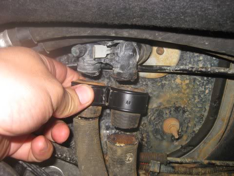

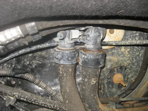

another issue with the Xantia, i have a slight leak from the heater hose to the heater core.
is this the start of the dreaded heater core failure i have been warned about or is it something easer?

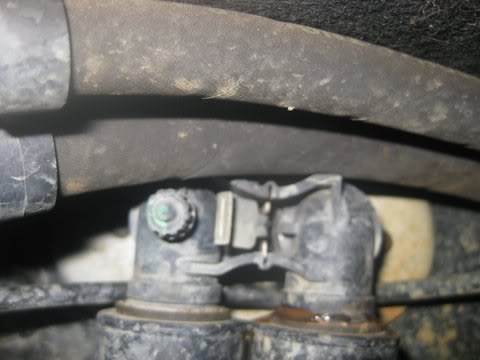

Is it actually leaking from the heater matrix socket that those pipes plug into, or is it a hair line crack where the elbow on the right hand pipe starts?

That's how they break here, Xac. It's the heat, mostly.

Looks like it will be time to source a good set of pipes from a scrap car and splice them in as a replacement.

That's almost a certain folly; they're all crook, and not exactly common either.

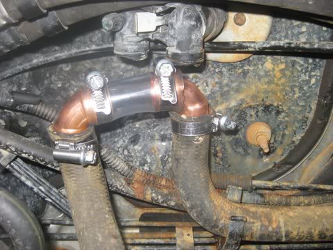

ok, this weekend i'll be bypassing the heater core. don't even know if i'll bother replacing it as i can always put on a jumper or long trousers if it ever gets cold enough here.

I used a 19 mm plastic irrigation elbow for the bypass, and it lasted for years.
I was wondering what size the hose ID was. Thanks.

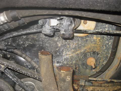

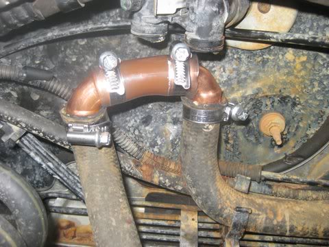

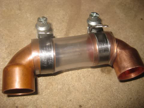

Well bodged up a bypass today.
I did a shed clear out a few months back and chucked out some 19mm (3/4")tube as i only had about 600mm left, so being as i'm to tight to buy another length ($20) as i wont need any more around the house, every thing else is 1/2". i spotted some pool hose in the hardware store the right size ($1.50) and 2 x 19mm right angle (2 x $1.50) and i already have loads of hose clamps. so lashed this together to do me till i get the parts to fix it properly.
the pipes broke at the top of the hose so i chopped them from just bellow the fitting. the fitting pretty much broke in 1/2 once i touched it.
before filling the system
and now filled but only with water
now i need to flush it and fill with antifreeze tomorrow.
