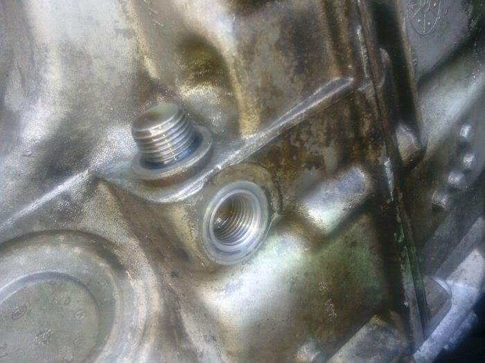

Hello. I can't find any info how to check oil level in my c8 auto gearbox (al4 20ts15). Any help? please.

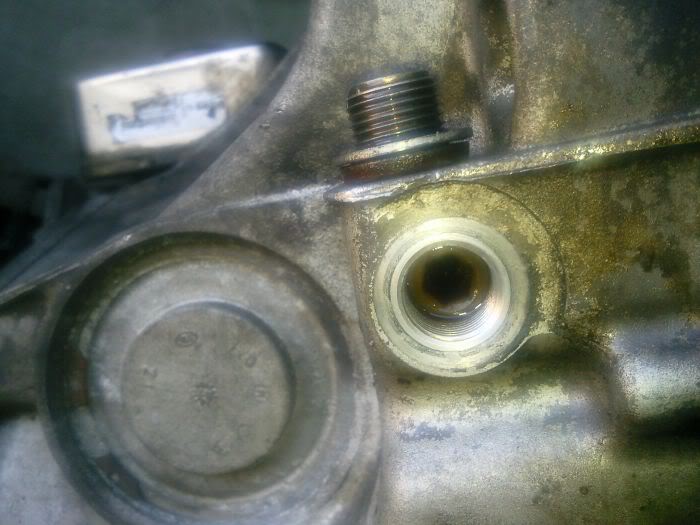

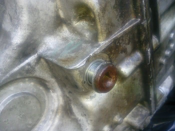

Hi. Addo, thanks for the reply. I'm afraid that with C8 there must be other way to do it
Instead of "bolt inside a bolt" I have a drain plug.

Re: AL4 20TS15
That plug looks like it’s too high up the side to drain the box.
My trick for checking the level is to open the filler plug and look inside.
If the works are dry, it needs topping up.
If you see oil, there’s enough of it.
