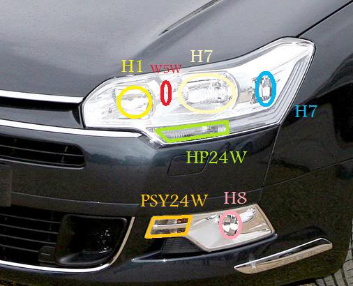

Hi I have an 11 reg 1.6 C5 Estate the hand book says the front indicator bulb is a HP24W. My local agent says they are £37 each plus vat and come in packs of 10 as he has never stocked these he is unwilling to stock 10 just to sell one. My indicators are ok at the moment but am making up a bulb kit prior to a trip to Germany via France. I have trird the internet but cannot find a supplier. Can anyone out there help.

Isn't HP24W a white daylight running light bulb? Yellow would be HP24Y. I think this is actually a typo in the owners handbook, and the same typo exists in the Dutch and German language versions.
Indicator bulbs are PSY24W and you can buy a pair from ebay for £15.
