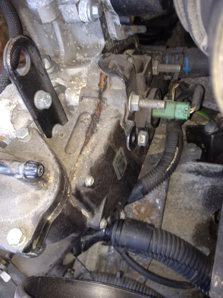

This is usually the water temp transmitter failing, it is in the plastic thermostat housing , where the top hose goes to on the engine. The terminal colour is usually green, and the switch is held in with a horseshoe clip.

On our car I can't see any wire inserted into Thermostat hsg. Can't find way of uploading pic that I took.
