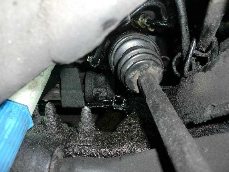

Evening all,
I finally managed to get underneath and have another good look at where the LHM leak is coming from. Firstly my rocker cover gasket change did not stop all the oil leaks. So that another one to find!
Secondly it would appear that the offside boot on the steering column has come off!
Is there a special clip to hold this onto the column?
In the second image you can see the LHM below and above. How is LHM escaping from inside that boot?
- Posts: 54989
- x 8321
Re: Xantia LHM leak near front height corrector
The steering rack pinion valve (the bit the steering column attaches to) is leaking internally into the rack.
There is no clip on the fat end of the gaiter, just a stiff rubber band. I suspect enough LHM has got in to pop it off under weight/pressure.
The gaiter will pop back on.
Have a word with Pleiades about a pinion valve overhaul...
